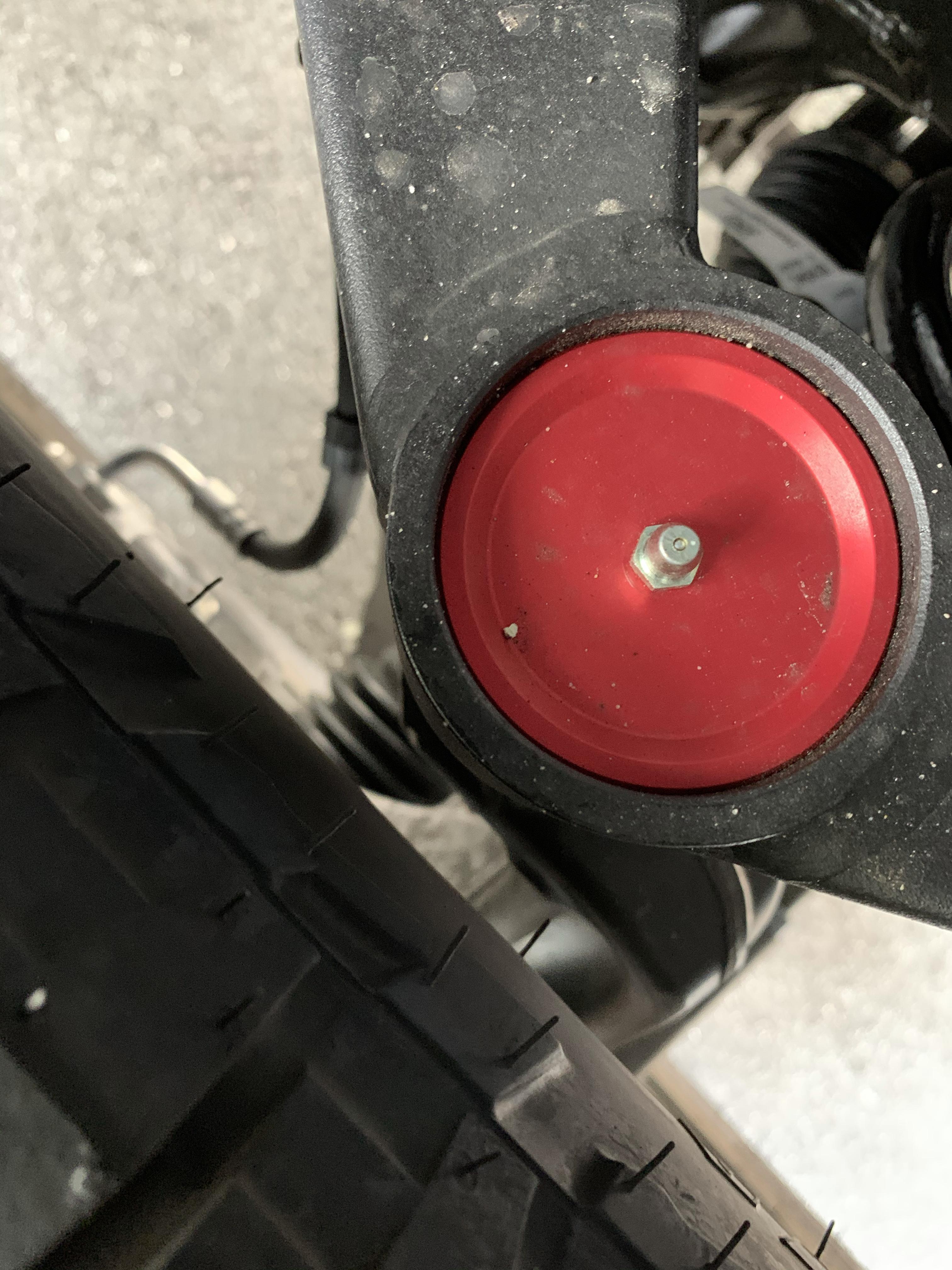

IMO Definitely go with Bilstein or Eibachs. I had the motofab spacers and they ride like sh!t. Tried to go the cheaper route. Ride quality suffered.
Eibachs were $215 shipped. Install was like $300 and I had Zone UCA’s installed as well.
I’m running 275/65 (34x11) on stock rims. Going wider on stock wheels is very tight.
Here’s a pic of the stock tires on stock rims with the UCA’s (it’s very close to rubbing)
I’m looking to fit 285/65 or 295/65. Do you think the additional half in will hit th UCA
