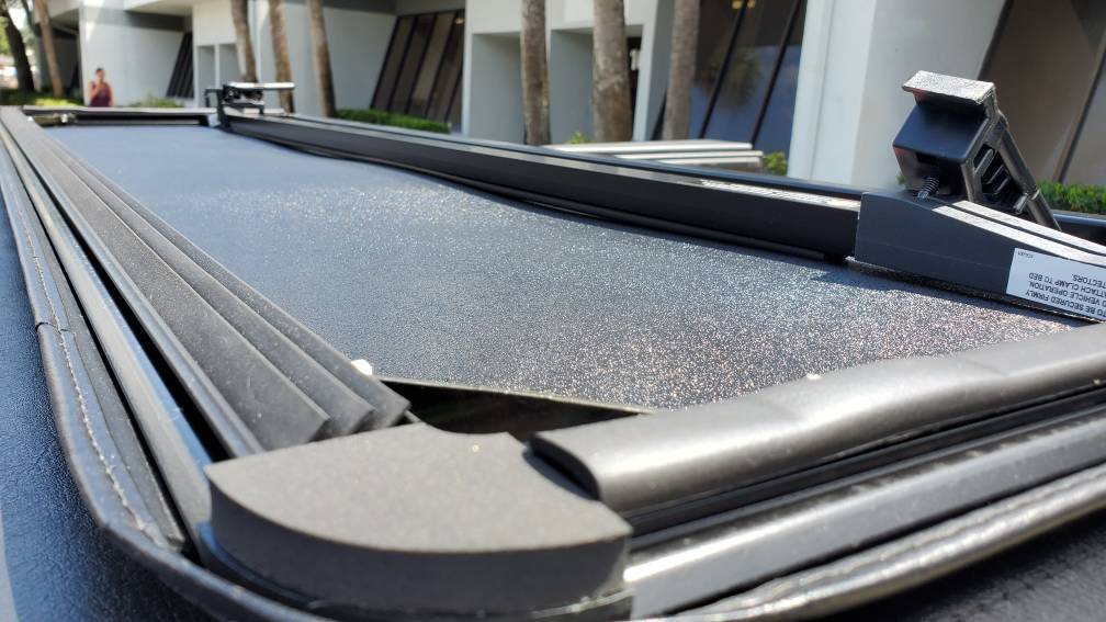

Thanks for the pics! So it looks like the cover isn’t sitting right on top of the bed? What I mean is it looks like there is a gap or space underneath it?
Here is a look at the underside and closer when sealed.

Ok that makes sense, thx for the pics!
So from what I’ve read in this thread... only the Gator Hybrid, or diamondback tonnoau covers will work with front brackets on the bed?

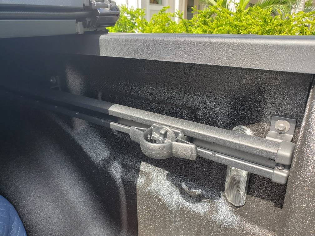

Circling back on this, here are some photos of the BUG rail and the bedcover clamps. You can see the braces in the front and where the clamps attach to the rear of them.

Not to derail this thread (pun more or less intended) but is that side railing there painted? That's the only thing I'm not happy with on my truck. The aluminum side rails. I was instantly thinking of painting them or having them powder coated for aesthetic reasons. Anyone done this?
No, not painted. It came that way as part of the Bed Utility Group. From what I've read in other threads, it seems that there are different rails out there that are silver, which is what it sounds like you might have on yours.
If you order the truck with the Mopar soft tonneau cover, it comes with different rails, which are black. If you don't get the cover, it comes with rails (that are actually different than the black ones) that are silver.
