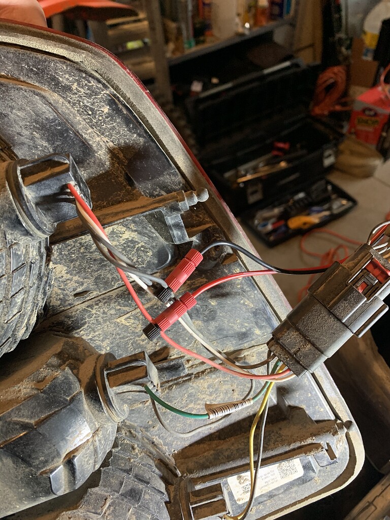

Great information, just what I needed as I just had a camper shell installed--the installer used the T-adapter to tap into the trailer connector circuits, and of course the truck started experiencing the issues that you mentioned. My unit, a Leer, also has an interior light and so uses the 12V auxiliary circuit--I wonder if that circuit also has the current sensing capability. I will test for that and report back.
Confirming what rlcool said about the white w/ purple CHMSL wire location--see attached photos. On my truck, the wire was not completely taped, a little bit was visible. The tape was a separate piece, so it was easy to take off. I butt spliced it to the camper shell's CHMSL lead, and connected the ground in the same way as rlcool did--works perfectly.
