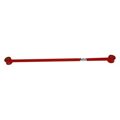

Brackets arrived today, but I’m still waiting on the panhard bar. Now I have to wait two weeks or so to play with my toys. I may need to seek therapy.

Can this be done without the panhard bar, as long as it is temporary? How far off is the axle with the stock bar? The panhard bar looks like a pretty quick install. So, maybe I can do it one evening after work. HMMMMM! I might have to get started today and drive the Jeep (sketchy) to work for a few days.

It’s close to an inch off with the stock bar. Since the spohn bar comes with the stock setting. You really see how off it is before you adjust it.
