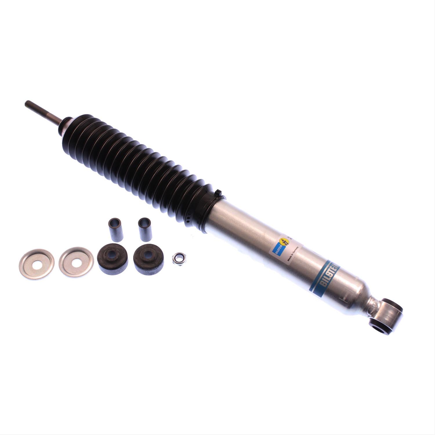

Rear Bilstein 5100 shocks from a early 90s ford ranger. P/N 24-185684, ASIN # B004WO9JK2
www.summitracing.com
Bilstein 24-185684 Bilstein B8 5100 Series Shocks | Summit Racing
Free Shipping - Bilstein B8 5100 Series Shocks with qualifying orders of $99. Shop Shocks and Struts at Summit Racing.
With the spohn panhard you do not use the maxtrac relocation bracket, nor do you use the sway bar spacers in the kit. For the 5100 shocks you swap the maxtrac shock sleeves into them.
This is from @ferraiolo1 thread. These are the shocks I plan to run. My Maxtrac lowering installation
I don’t know about the maxtrac sleeves though. To my knowledge there aren’t a lot of shorter shocks for these trucks.
I’m not using a lowering kit. I’m just swapping out the springs for the air bags and putting on the Panhard bar. Do I have to have any other parts?
ferraiolo1
Aug 18, 2021
2,312
3,605
North Central PA
No, I have them and they feel MUCH better than the stock shocks. You just have to swap the pushing over. It’s all detailed in my maxtrac thread.
Thanks. I guess to make everything even, I should get the matching shocks for the front.
ferraiolo1
Aug 18, 2021
2,312
3,605
North Central PA
They are for an old ranger with a 6in lift. Trust the process of the people who already did the research.
