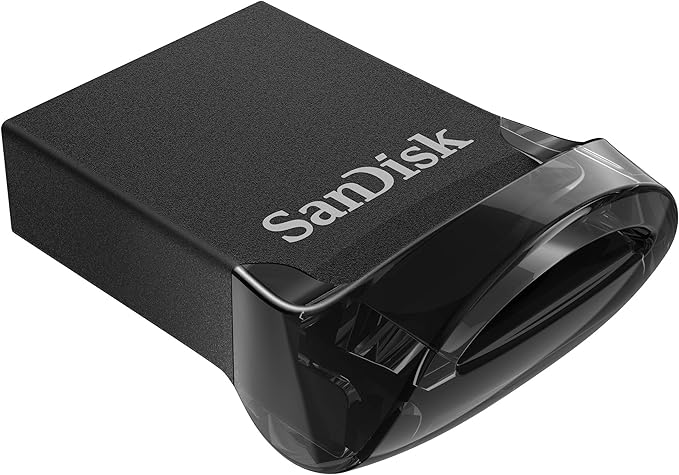

Also, I think if the source you last played is slow to load at startup and temporarily unavailable then it will jump to another source that is available at the time. I've found changing thumb drive brands/speeds can reduce the random selection.
I use a SanDisk 128GB Ultra Fit USB 3.1 Flash Drive and it's what I listen to almost exclusively when in the truck. I still occasionally have it randomly select a source at start up but it is very rare.

my home screen has TomTom Nav, confort selections (sometimes fails to load) & Media .... i also use ScanDisk 128 GB usb, same one that our 2 jeep Gladiators (switched them one at a time w/same resulting problems) also note the TomTom fails to load alot .... i am beginning to think it is a Voltage problem because this randomness happens most often after either the Ram sits a few days or after eating while listening to the radio (usb) ... this UConnect 5 and the 12" screen are a piece of **** .... i tried messaging @RamCares but i guess they really don't care 5 days later and NO response
