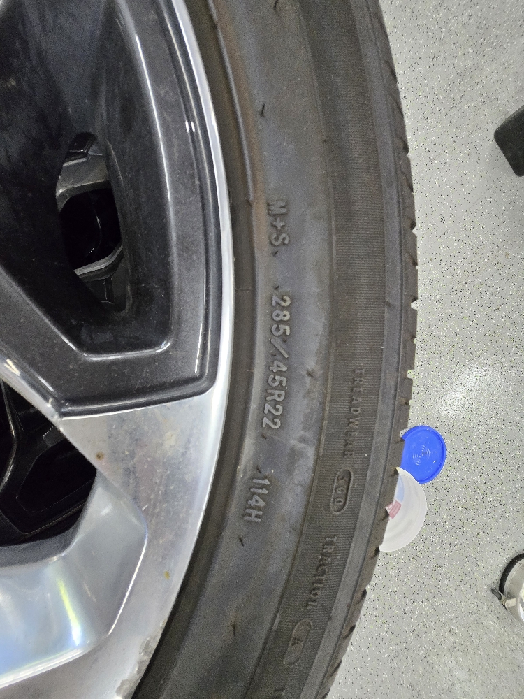

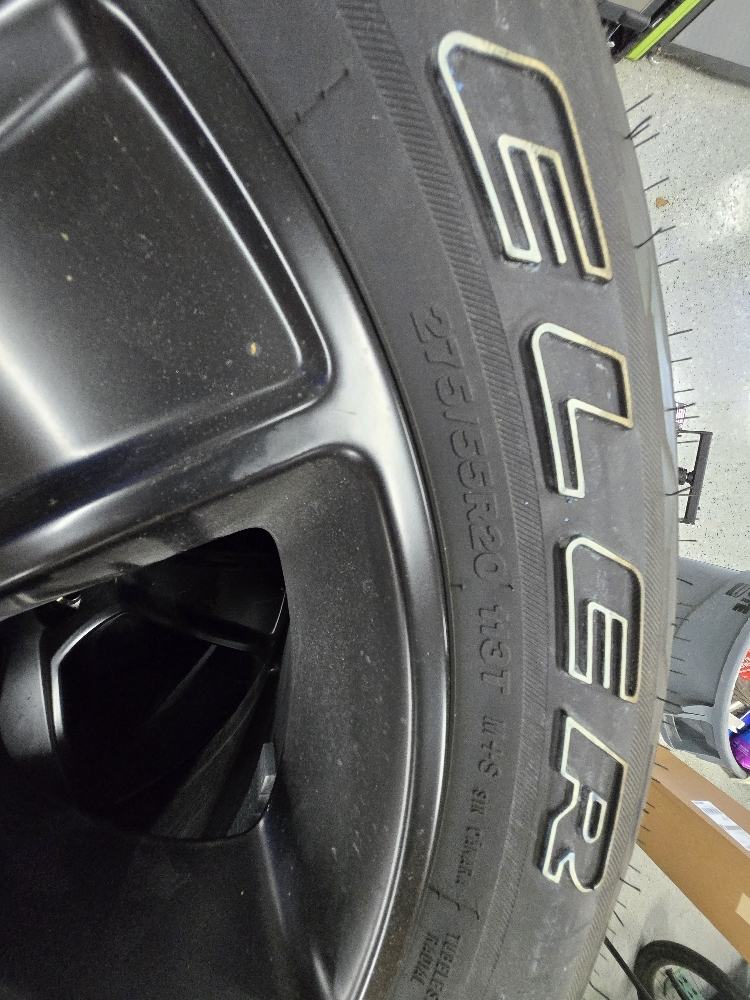

So I have a limited 2019. Not sure if the brakes are different larger than other trims. I bought these smaller wheels and am wondering if I'll have any sizing issues mounting with the brakes?
It looks like the overall height with smaller wheels but larger tires are overall a wash and same height.
Thoughts? The new wheels are the black ones.
Sent from my SM-F956U1 using Tapatalk
From the pictures it looks like the stock Limited rims ? they should fit no trouble.
Me bad you are going from 22" to 20" rim's ? I didn't see that at first.
They're ram wheels just not sure what trim they're off
You shouldn't have any issues, I'm running 18" wheels on my 2019;
