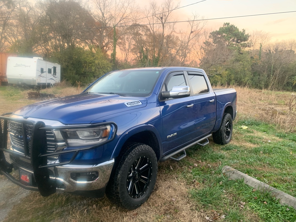

I have 295/60r20's but with the revel links on a 20x9 rim with zero offset. You have the off road group so your eyes lifted 1 inch already. I'll bet they fit. I have plenty of space all the way around but again, I have the revel links.

I got at least an 1 1/2" over stock. Your height won't be the issue but if your leaning toward a +19mm you might rub on turns. I have a ton of clearance but I also went with a zero offset. Tough call....

Rough Country 3.5, Cooper 295/60/20 A/T3 XLTs, 20x9 Moto Metal MO982 AMP (0 offset).
