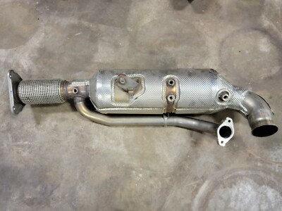

Today, I decided to crawl under and see what's making the noise and I found these, on on each side just clicking, whining, clicking, whining:
Some internet searching and I confirmed they are what they look like, butterfly valve actuators, or more specifically Exhaust Valve Actuators.
I assume they have something to do with the EGR system.
I'm just really curious why they're so busy when the truck is completely off and locked.
I don't know if they're opening/closing continuously or if they're just constantly re-checking their position, but it seems that if they're working so much, they're bound to eventually wear out and fail.
It is controlling the rate in which the SCR system injector and DPF cool to keep them from "mudding" up. I noticed this on my 3500 and that was the explanation given by a mechanic at the local diesel shop. Seems it is keeping heat then allowing a cool burst of air to create a syphoning drying effect across the units to evaporate any moisture it senses in the system. Is he full of it I don't know but it has been the best explanation I heard.
