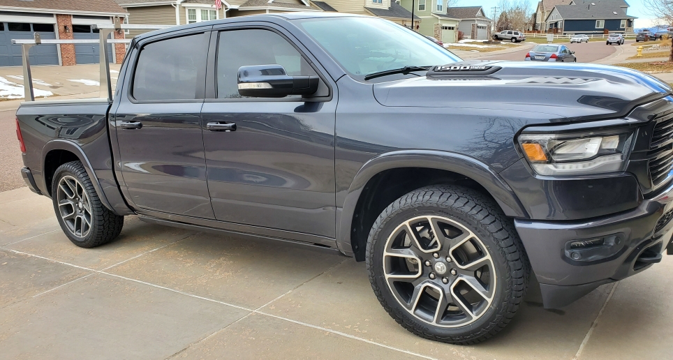

Just put on terra grappler G2 305/45/22. No trim no lift no rub??

Thanks I typo’d and meant on my 22 i have no rub with the G2 305/45/22.

No rub with those 305/45/22 nittos .... stock no level or lift. Meatier side walls with the terra grappler G 2

This help??

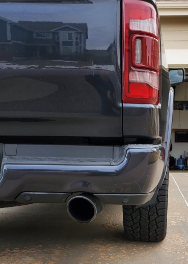

stax - I'm ordering these tires after seeing your post! Can you post a photo of the "stance" on your tires? I'm wondering if I will need new spacers or if the tires line up flush with the fenders without spacers. Thanks!
with the nitto G2 305/45/22 no spacers needed.. it is flush maybe a pinch past the fendersIMG_1808.jpegIMG_1809.jpeg
