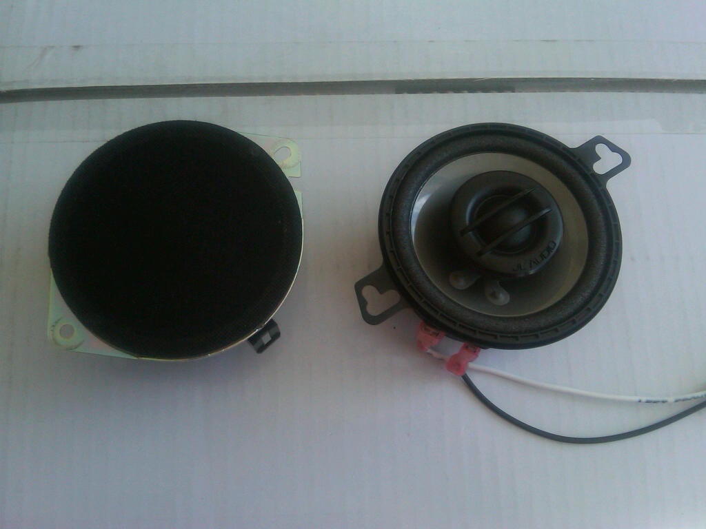

Hey guys-- I've had my truck for a little over a month now, and I'm getting around to upgrading a few things. I ordered these Kicker 3.5" speakers to replace the washed-out "Alpine" speakers in the dash. I'm only replacing the corners at this point, but I may order a second pair, if I can't pick up someone else's spare within the next few weeks. If I do end up ordering a new pair for one speaker, I'll post my spare for sale on here.
I purchased these on Friday, and they arrived yesterday(Tuesday). I was able to pull mine out and slap the new ones in....all in less than an hour. I opted to splice the wires in for the new speakers with solder, rather than buying the $10 metra connector for each side, plus the 8 bucks shipping. A good solder joint beats a connector any day. I heat-shrink tubed the solder joints when finished to keep everything tight and tidy for years to come.
It sounds fantastic. A definite improvement over the factory Alpine setup. I'll probably soon be swapping out the 4 door speakers. With these new Kickers sitting in the windshield, you definitely need some two, or three-ways, in the doors to balance it out a little. I'm loving it, though. Super happy I spent the 40 bucks to get those Kickers here. I plan to swap out that sub behind the back seat, too. I've read there's a Pioneer 8" shallow mount that's supposed to run pretty well with the factory amp in the Alpine setup. If anyone has any experience with this, I'm all ears.

I just checked. The surround sound makes zero difference. The headliner speakers are on, either way. They just have zero output. They're trash, and aren't even setup to perform their role. They don't even have a tweeter. They're just little paper 2.5" speakers. A nice set of 2.5"s with a silk tweeter should liven up the entire cab.
