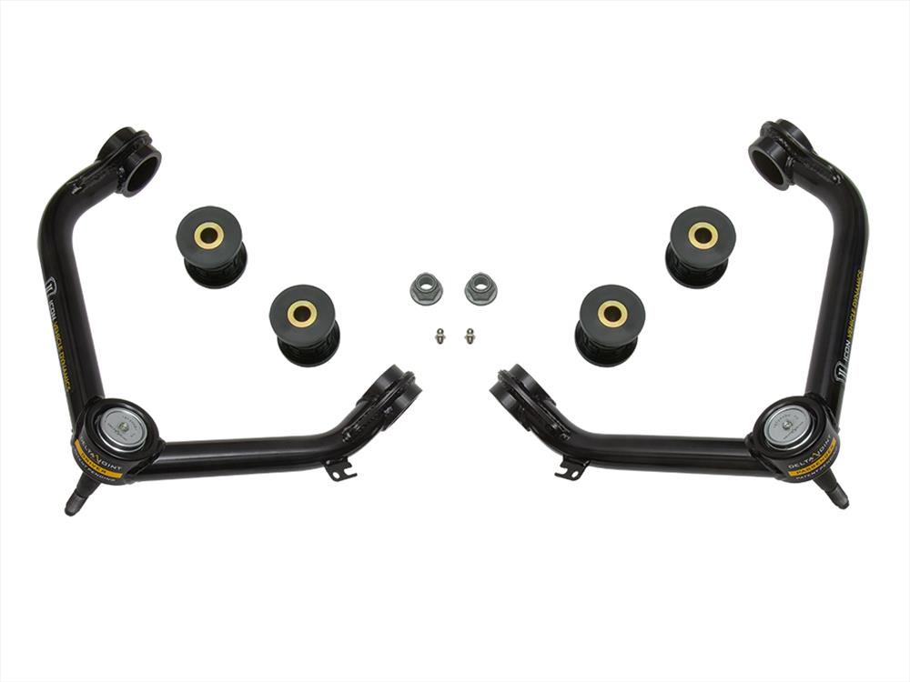

Choosing UCA's comes down to what you're doing with your truck, how much maintenance are you willing to put up with, how much lift you have etc. Most have a built-in offset that will work in 2-3" lift applications. There are a few that are buil with the stock offset, why ? for those of you using 4-6" brackets lifts that need a factory UCA for proper geometry. An offset BJ in one those kits will look pretty much the same as if you installed that UCA with your factory height suspension. the BJ will have a severe angle inwards because of the built offset, at least if a 5100 type strut at 0" lift is used, moving the strut perches creates a lift in the same fashion as one that has stock height, then if you reached 2-3" lift that way you can use an offset UCA. Fabtech has stock lenght offset with a uniball, i believe Rolling big power as well. i keep a list of UCA's for the 4th gen trucks, i'm sure all of them will work in the DT trucks. We know TC, Icon and BDS use the same part#'s so no changes on what they're doing in their UCA's for the DT trucks.
Uniballs, VS traditional BJ's VS Delta Joints all comes down to preference, the video in post# 5 is an excelent source for more details and i'll refer to that video for explanations. I've used Uniballs before and you can't beat their performance with standard BJ's, i don't think you'll find a race application using that style of BJ's. Delta Joint is new, i think couple of years i'm giving them a try right now in my RAM and so far so good. I had Zones (rubber bushings and hd bj) before and without changing anything else i can tell the difference in riding, maybe because my coilovers are literally almost maxed out and perhaps the BJ in the Zone doesn't have the right angles at that height as the suspension cycles, i have no idea but the difference in the way the truck drives over rough stuff is now more noticable and i haven't changed anything else other than UCA's.
I put some pictures here comparing the angles on both uca's.
looking for some input anyone might have if they have installed the icon uca's on their truck?
