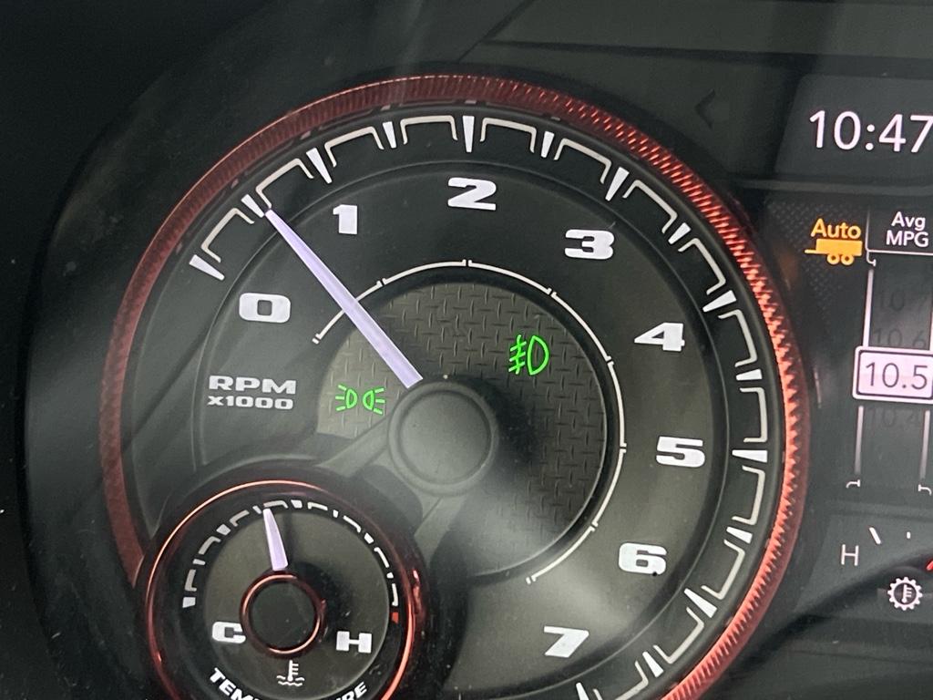

I've seen a few other threads on this but I've never found any resolution so I figured I'd ask and see if anyone else has similar experiences. I recently purchased a 2020 Ram 1500 big horn with the 5.7 hemi. The truck shakes very noticeably when at red lights or in park. I'm not new to trucks and I've owned many v8s that let vibrations through, they're big motors after all, but this is more erratic and feels like a misfire, however, the idle is rock solid at 500 with no variation. I had the dealer look at it and they said "they just do that" but I'm not entirely sold as I drove a few others and don't remember noticing it. With the hood up and the engine running I can see the whole motor shake a bit when it has it's "stutters". Would exhaust manifold issues (bolts or crack) affect back pressure enough to cause this or is it more likely a vacuum/throttle body issue?

Is it really 500 rpm at idle? Seems a little bit low. Maybe it's struggling to keep running.

Idle is about 750rpm.
My idle is 500, and it only shakes when it's that low. Today I went to a Ram dealer and ran a few 2020 and 2021s. They all shook in a very similar way. Mine is a bit more pronounced, but it is the same thing. I also run 89 as recommended and it doesn't make any difference that's just the way it is. I'll try some 5w-30 next oil change and see if that makes any difference. Most likely though, 500 idle is too low and that's why it does it.
