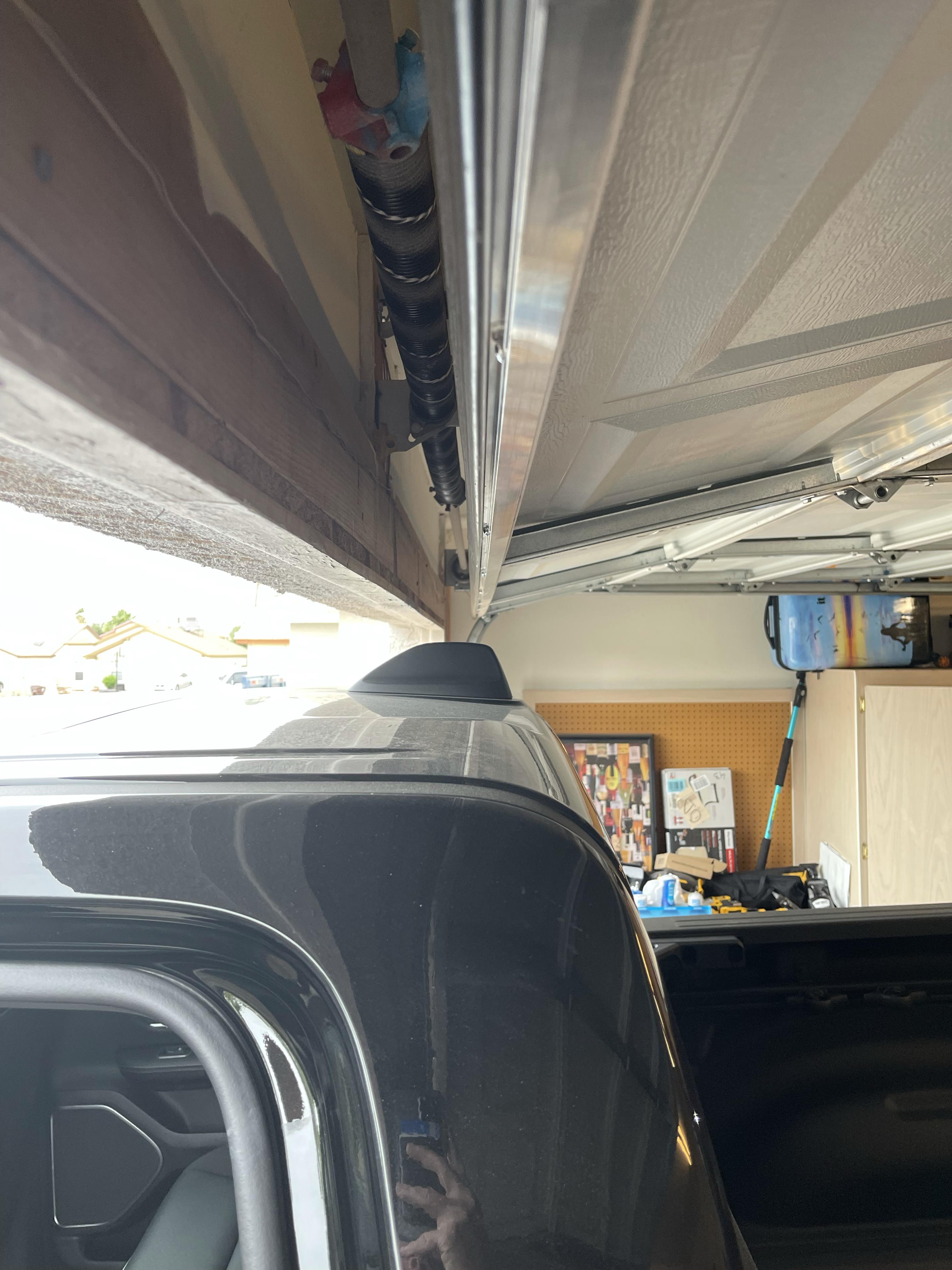

I can measure for you today. I have bilsteins and ORP and SST UCA. Shop was imbeciles, so they couldn’t figure out how to use top hat without preload and bilsteins at a lower notch, but I’m at 3”. That could give you a good measurement. For what it’s worth I’m this close on a 7’ home garage.

I’d say that’s right. I have a 4” lift on the front but I used a 2” spacer (same height as the 3.5” SST kit comes with) in the rear & with 35s I’m at about 6’10 or 81-82 inches. The shark fin antenna is the tallest part of the truck so since I have the same height rear lift and 35 inch tires I should be at the same height as what you’re talking about!
