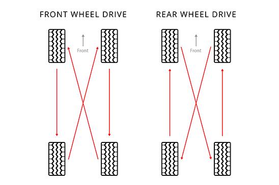

Hey all, silly question, but it’s my understanding that I should get my tires rotated every 5,000 miles~ with oil changes, front to back. It is front to back for the rotation right?
Also, is there ever a need to rotate the tires left to right?
Tires are Nitto Ridge Grappler 295/65/r20

Yes and yes lol.. I've always rotated mine with every oil change it makes them wear evenly and extends the life!... A good tire shop will be able to tell how they need rotated but yes front to back and side to side both... Usually it's a criss cross pattern
All vehicles/setups wear differently but basic rotating patterns look like this ¬

This does not make any difference between front and rear wheel drive as the tires end up in the same spot.
Is the picture I found on Google.. Lol I think it gets the point across
