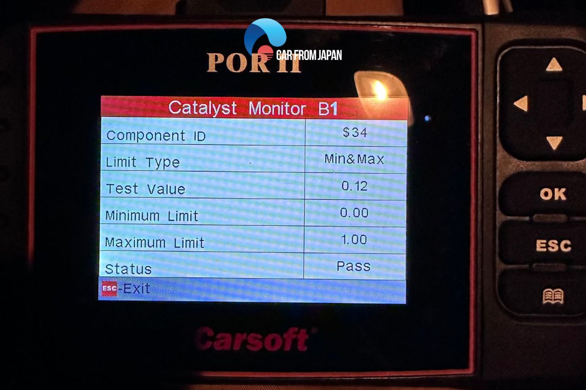

I never knew this was a thing, we pick up our new vehicles already tested. Here's something I found when I was trying to understand what you were asking ;) Good Luck.
Thanks bill-e! I'll give this a try. It's because it's an out-of-state vehicle from Louisiana and California is strict about cars that come from out-of-state, even if they are 50 state compliant.
