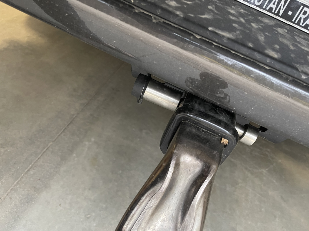

Here goes mine. GEN-Y GH-313 5" drop, rated at 1500lb tongue weight, 10,000lb load capacity. I love it because I have been rear ended with it mounted and it merely put a scratch on the ball and saved my bumper/rear end. The other car didn't look so hot. The part I love about this over a B&W or whatever is it is like having three 2" receivers. I have a PAKMULE hitch basket that interferes with the tailgate open if it's in the normal receiver hitch location. I put it in the middle and it works perfect. I can spin the ball to the backside, rotate it where the balls are horizontal etc. Here are some pics.
Also I CANNOT stand a hitch rattling. So what I do with my trucks is drill and tap a 3/8" hole and put a grade 8 bolt. Just a little snug does the trick. 20210307_154620.jpg20210307_154642.jpg20210307_162225.jpg20210304_154131.jpg20210307_150833.jpg
