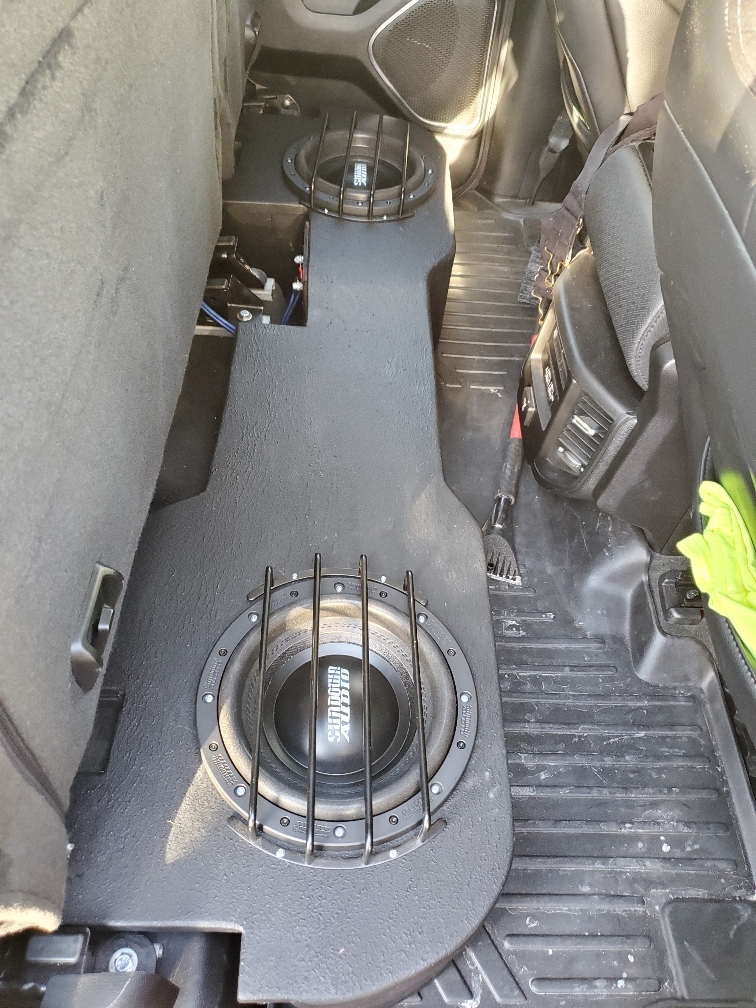

Mine is a Quad Cab and it was a challenge to build a box that doesn't stick out too much and still have adequate airspace for what I wanted but I did it, 2 10" Sundown Audio SA v2 sealed on 3000 watts, sounds great.

I have a crew cab. I'm just being as stingy as I can with the space, but still get some decent SPL out of it. Ideally I could still maintain a little storage under the drivers side.
I don't have much room left
