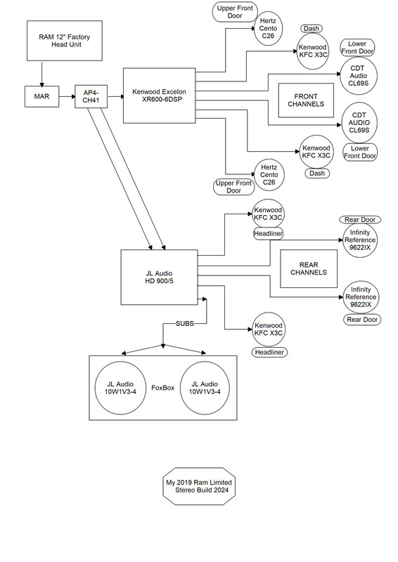

Here's a diagram of my 19' Limited - I know it's not the same, but should give you an idea of whats involved.

I don't know how far that cheap LOC is going to get the OP - with all the $$$ spent on equipment that looks like the weak link (as opposed to an AmpPro or equivalent)
