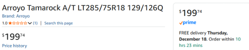

Yeah after looking for a somewhat matching tire for the spare and that price is high, I'm going Cheap and put the other money for a direct replacement.
