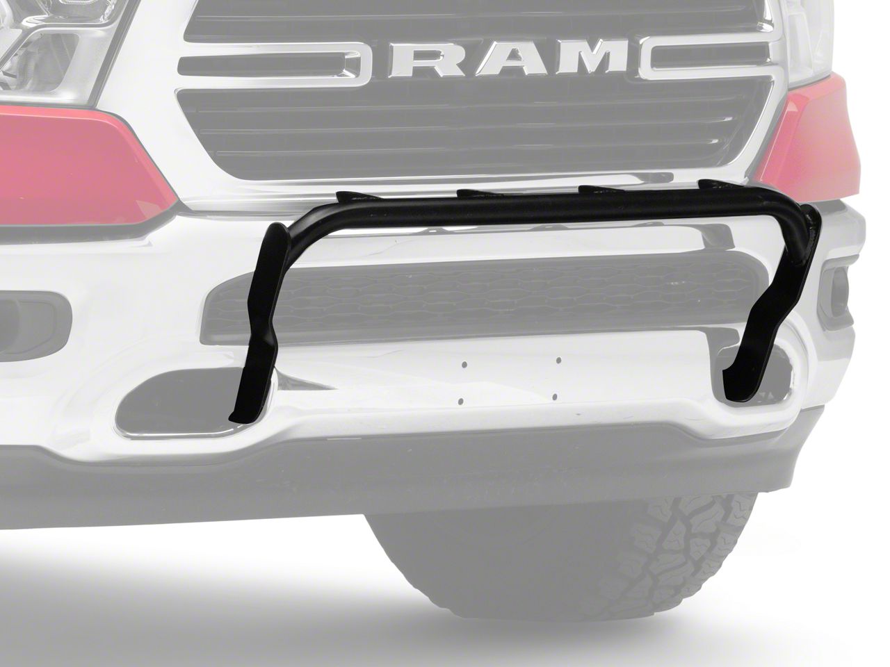

Lately I'm having 2ND thoughts on my current position of my lightbar
It's a license plate mount that is super strong, but I'm afraid some dummy backs into me at a parking lot destroying my $750 Rigid light.
Perhaps mounting it higher would be a better place for it.
So I have been looking what's available. I ordered the sleekster bar last night. I hope it goes on with the tow hooks and its an easy mod.
They claim it does, and they seem very solid. I figure I have room to add 2 small diode dynamics pods one on each side of the main Rigid light for extreme side lighting in a flood configuration.

The sleekster lightbar is on!
Installation was fairly easy. Remove the tow hooks, place the plate installed on the frame then reattach the tow hooks. The lightbar fits on the mounting points for the tow hooks. Then you need to wiggle the parts to align the lightbar. One side was a little stubborn, I wiggled some more then it dropped in where I could add the other 2 bolts. I slid out from the truck, checked the fit then went back underneath and tightened everything up. The bar fits like a glove. It's a nice addition and now I have protection for my Rigid lights. I added two smaller flood lights angled to shine the sides of the road.
I recommend the lightbar.

The light bar mount is of excellent quality. If anyone wishes to do the same I recommend the mod.

Only a negative about the light bar. If you have the parking sensors in the front bumper of your truck,, that could trigger alarms and you will be forced to turn them off. In my truck I don't have the bumper sensors.
