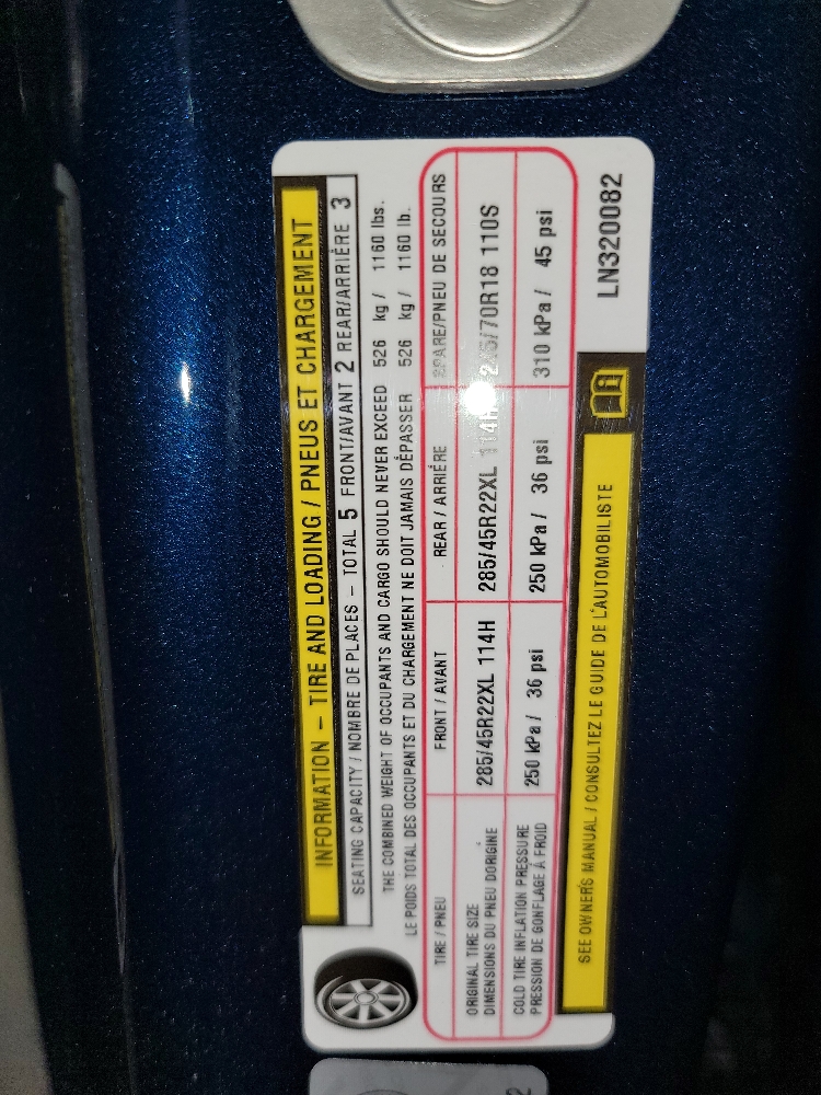

Yes that sucks! I am sure Ram would get more Canadian sales if they allowed the diesel for all trim levels. Having to step up to the Rebel or higher trim levels to get the diesel is a big step in price.
It is frustrating and impossible to look for the exact towing and payload capacities because the website does not allow for you to add specific options, all those options increases the weight of the truck and reduces both payload and towing capacities.
On the website it shows the Rebel crew cab diesel payload at 1720 lbs. My 2020 crew cab Rebel diesel has all the options but no split tailgate and no air suspension, so the extra weight of those options brings my payload to 1326 lbs. that’s 394 lbs lower.
I took a picture of the sticker on my truck. I also added the Ram.com pictures of the difference between the crew cab and the quad cab capacities. I did notice there is only a combined difference of 60 lbs between both Rebel models. The crew cab has more payload but less towing. I added the big horn crew cab and quad cab, I know it is not available in Canada but just to compare. There is so little difference between all those models, less than 100 lbs in combined totals, so going to the Rebel is not a deal breaker if you keep the heavy options out, like panoramic sun roof Ram boxes...

I've been following a few youtube channels, user OFFRD comes to mind, among others. His payload is in the 1600# range with Big Horn and offroad package with the ED. Specing out a number of 2020 rebels on lots with the ED across canada and then running the VIN for payload through the ram towing guide website. Most are in the low 1400's, some lower, as far down as low 1000# payloads (sun roof, ram boxes and MFT are the biggest culprits followed by leather). I've got a DS with just over 1300#'s of payload that is overweight now when towing due to growing kids. I tow with nothing in the bed and minimal stuff in the cab. Was really needing to hit about 1500# payload to stay legal long term. Looks like to do that without having to go gas, along with mid 6 to 8mpg when towing and 13 around town, I have to go to a 2500 diesel at $20k more, plus another $10-20k for a used commuter car plus the expense of double insurance costs. The 2500/3500's don't fit in my parkade at work, with no other options nearby as stret parking is max 2 hours and only between 9 and 3 when I work 7-4 or longer. (30-40 minute walk is nearest location for all day parking that would fit the height of the 3/4 ton). The other option is going with a FERD 150 diesel, but I hate the interiors and driving dynamics. FML.
MyRebel is loaded, I searched the inventory for a Rebel ED where I bought mine at Peel Chrysler in Mississauga but they have many options and the payload would be close to the same as mine, I don’t know where you live but if you can find one with less options to bring the payload up, and the price would drop, you said you would like a payload of 1500 lbs, it would be very close to that payload with less options.
Myself I am not worried about adding 1500 lbs to my truck, that’s only 174 lbs more that the rated payload of 1326lbs.
I did add inflatable airbags in my rear coils springs to level the truck when I load the bed, I hate having my headlights pointing in the air.
I attached an image of where I bought my truck, they have 32 eco diesel in stock and this is one of the cheapest ones. Good luck in your search.

Wow that is quite a difference, than my Rebel, the two main things that brings your payload down is obviously the MFT and your tires, your running air pressure is 36 psi front and rear, the Rebel is 55 psi front and 45 psi rear, I find that weird a 10 psi difference, better ride? I keep the pressure at 55 psi on all wheels but I increase the rear if I tow heavy or when I load the bed. The truck came with 55 psi all around, I should lower the rear to 45 psi for the winter, I have blizzak 10 ply, it would probably bite a little better in the winter.
