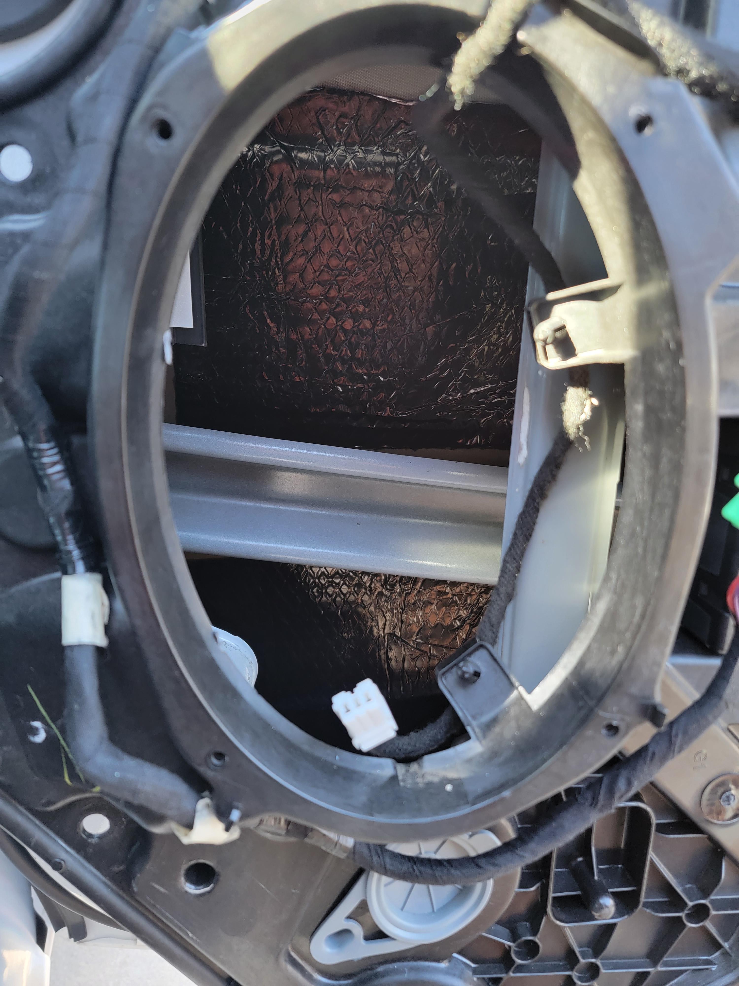

I’ve looked through the speaker opening and didn’t see anything but bare metal.

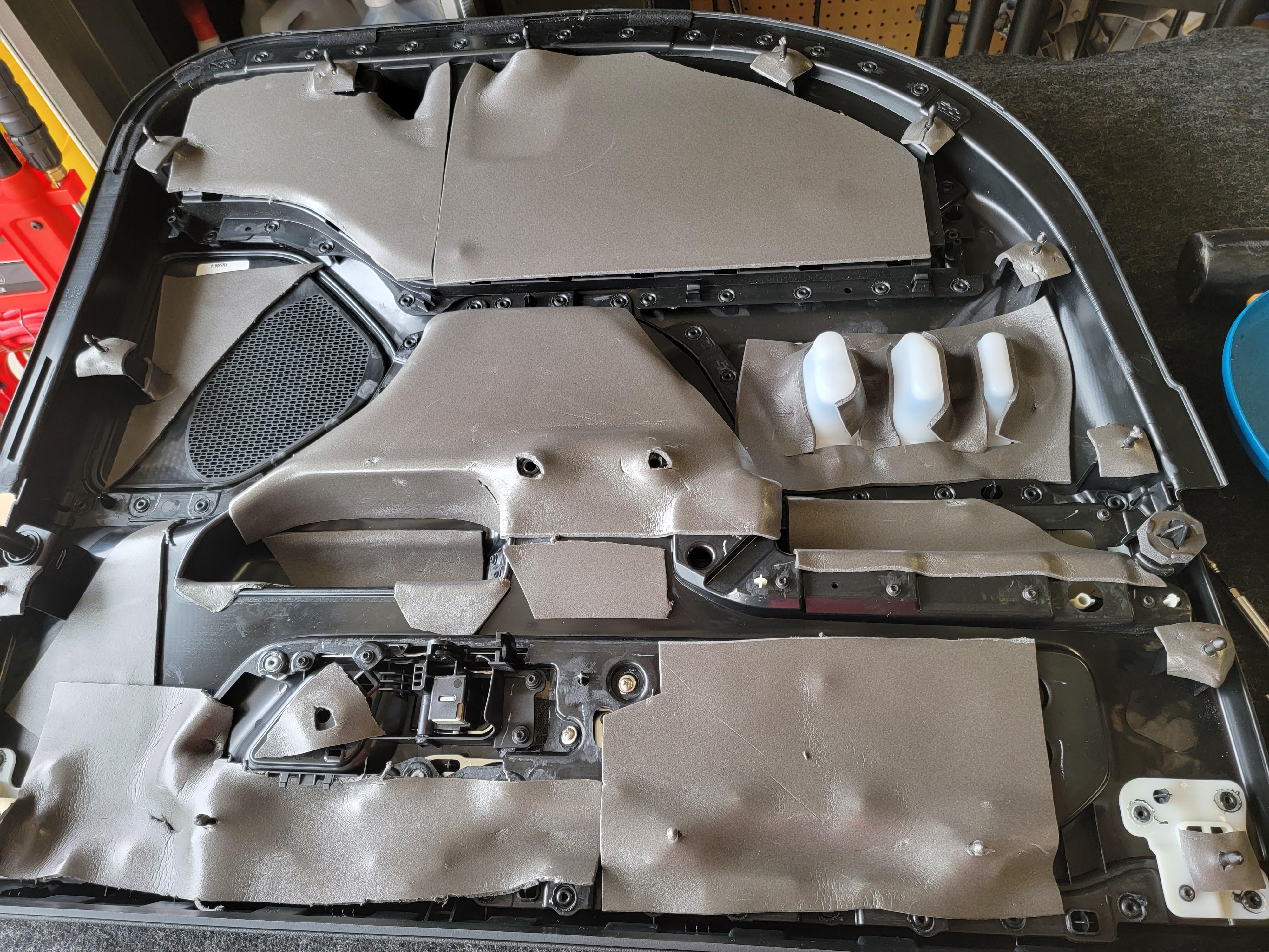

Eh... Kinda agree on doing inside of door panel itself, I personally dynamatted my entire 19 limited . Front ,rear doors, pillars, rear cab panel , rear floor ... Its a night and day difference !!! You dont need to take the plastic door cover off on the inside, go over it all, trace out needed holes and cut , take speaker out and do the speaker pocket as well as the back of the speaker itself ( yes its a dumb idea and some purist will talk **** but oh well dont give a **** it sounds wayyyyyy better ) its an easy job and you will absolutely notice it
Its painted ov

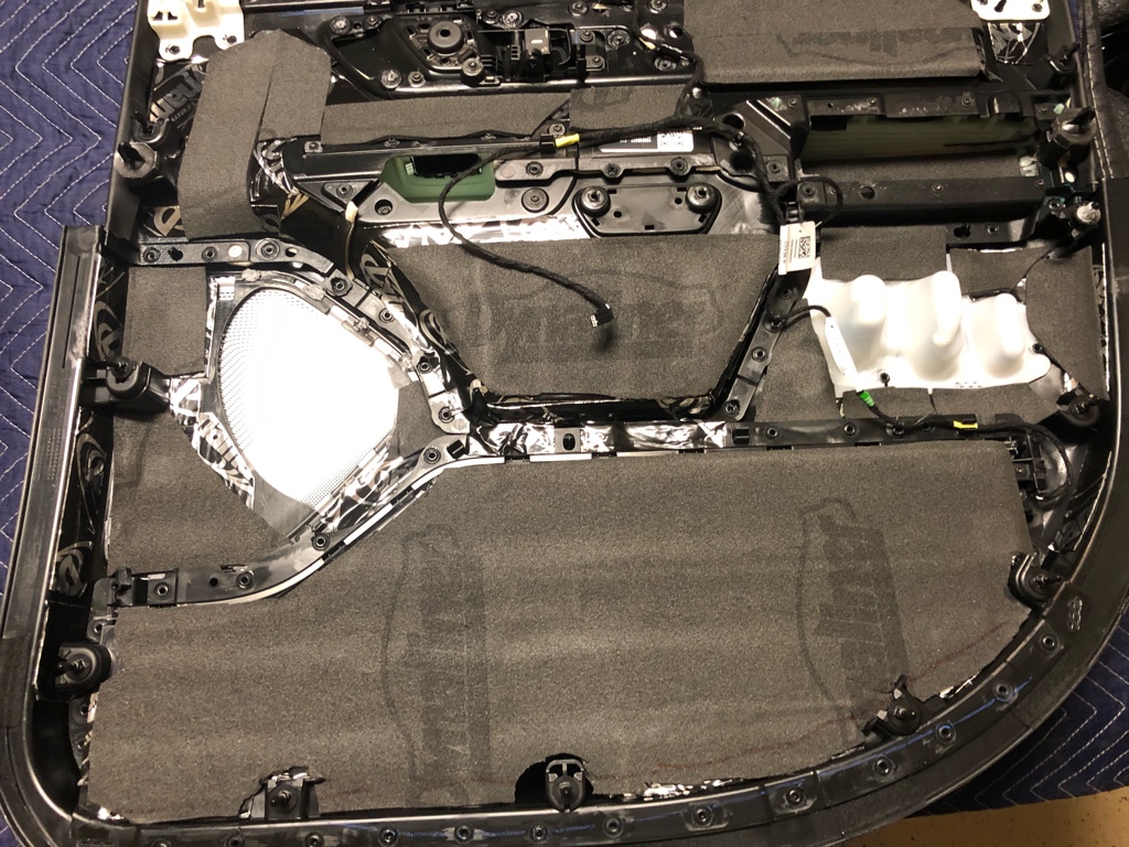

Did the full outer door metal in dynamat but didn’t get pic.

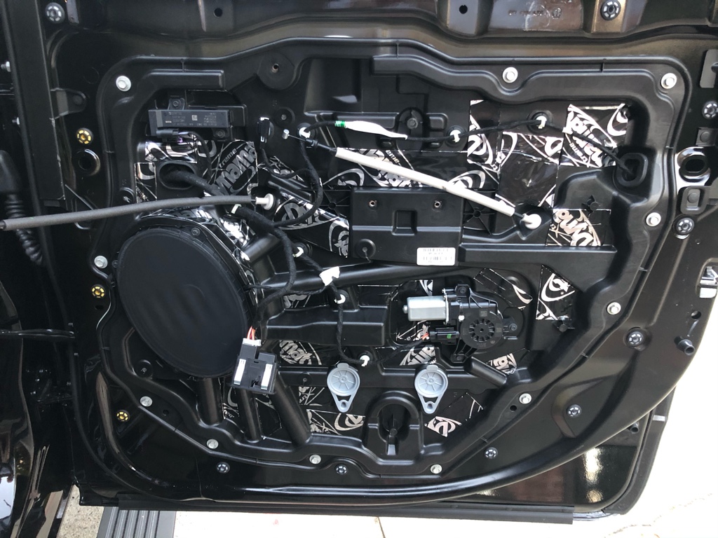

It's a pain, but you can remove all the bolts and squeeze your arm in the bottom and the speaker holes to get sound deadening on. Shove a roll of paper towels between the carrier plate and door to hold it open while you shove your arm in there.
Just FYI, there is some factory deadening in there, just not full coverage like we all "think" we need.
