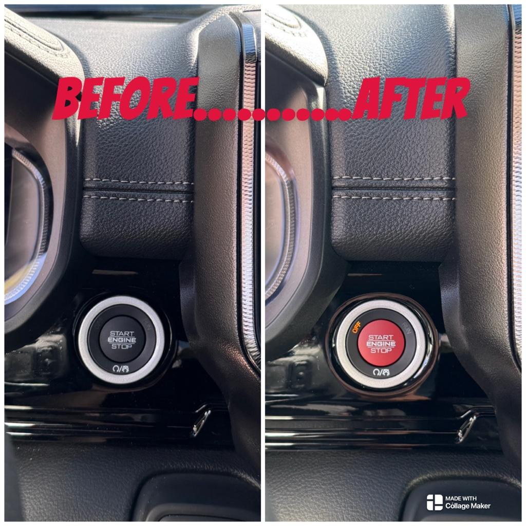

Red Ignition Switch Swap

So, from under the dash, what has to be unplugged and moved to gain hand access to the backside of the switch for its release? I thought I read somewhere in the forum the '25s were set up differently underneath than the earlier models which had open clearance to reach it?
I installed the RHO switch on my 2025 Rebel with my previous Laramie it was easier access to the switch now it's blocked with modules etc.
To install I first removed the 12" uconnect then remove the shifter and bezel.
I then reached from the where the uconnect was to depress the switches upper 2 tabs (for me with large hands it was tedious to reach them).
With the upper tabs free tilt the switch to free the lower switch tab then pull the switch out and unplug the electrical connector.
Finally transfer the silver trim from the old to the new switch.
So now it's essentially a reach-around effort thru the U-connect tablet space instead of from underneath. will have to give that some thought.
thanks!

That's how I did it. I removed the kick panel at first like on my Laramie but there was stuff in the way.
The uconnect has 2 screws in the top tray then pick a corner and yank it out since it's all snap fit.
