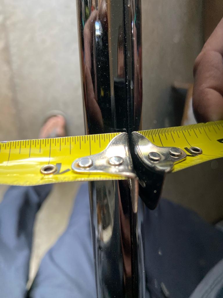

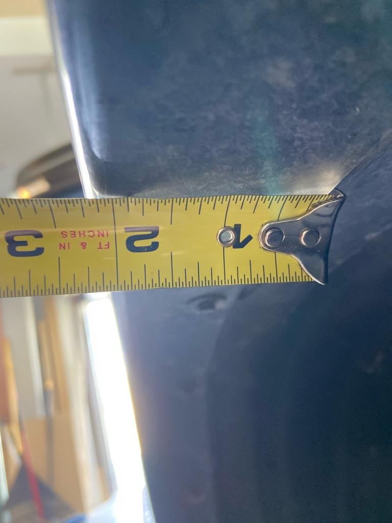

I’m trying to figure out how large of wheel spacers I’d like to go with, and I’m seeing some pictures that make me question if the Rebel flares are wider than my Laramie ones. Can anyone take the below similar measurements off a Rebel and report back if they appear the same?
Some pics below for reference.
Top is about 9/16”
Bottom is about 2-1/8”

Well, do you have any specs from your Rebel flares? Really interested if they’re wider.
I have 1.5” and 1.75” spacers on order. I see some guys with 1.5” look like they’re poking out, and some with 2” look like they’re flush, so I’m curious if the difference is in the fender poke.
Depths are identical for factory flares. What you're noticing is probably people with aftermarket wheels that have a near zero or negative offset which causes the wheels and tires to stick out more than the factory wheels.
Thank you for confirming dimensions.
I’ve been looking only at pictures with stock wheels with the same offset, so maybe just comes down to picture angle.
