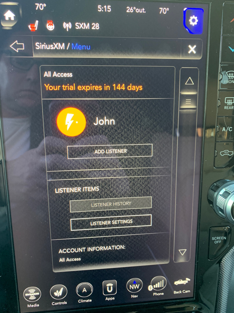

This happened to me as well. I could set the presets and as soon as I turned off the ignition and left the vehicle they were cleared. What I found after days of tinkering is that I had loaded personal profile for my presets. However I got to this screen last July after I bought it, and setup my profile, it disappeared a few weeks ago. Found it again and I’m all set.

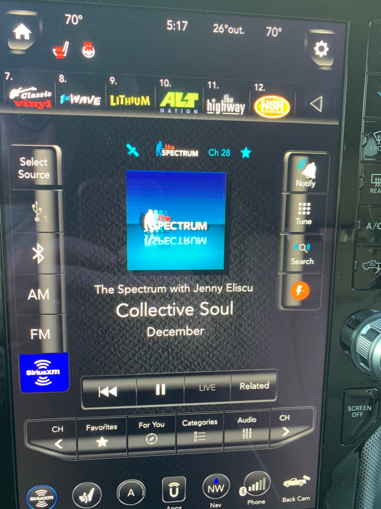

Thanks rlc2020. Some update for me. I decided to try in sequence the fixes noted seperately in a few threads on this forum. Specifically I cleared all my s1 and s2 memories and the key fobs. I then set up everything again AND then made sure to add myself as a listener on the sirius and then picked an avatar from the list they provide. Like your above suggestion it appears adding yourself as a listener and making sure that avatar is on the main screen helped confirm everything was complete. Park the truck overnight, get up for work this am and voila for the first time since I picked up my truck from its first service my radio presets were still there, woo hoo! Called the dealership and provided them the info and they were appreciative. Hopefully it stays working.
