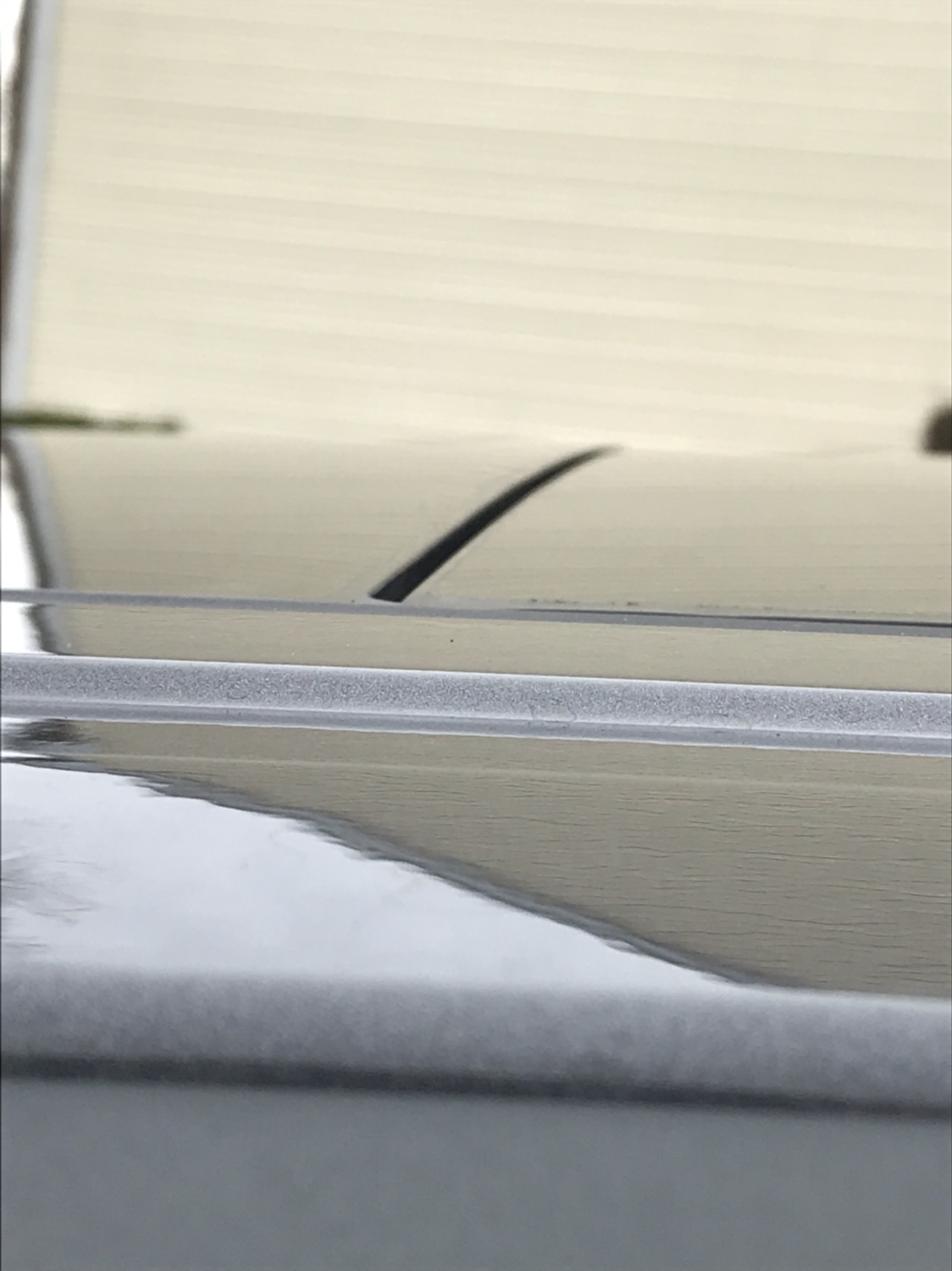

The next thing i noticed was when i was washing the roof i saw my panoramic sunroof was abit off. Is this normal or should i have this looked at?

The sunroof should be flush and needs to be addressed by the dealer.

Just dropped the truck at the dealership. The service advisor looked at the roof and said it is normal and water is supposed to leak in and go into the drains. Does this seem right?
Yes, a small amount of water that will leak in but I still don't think your sunroof is aligned 100%. After your previous post, I specifically look at my sunroof and it is perfectly flush, front glass to rear glass. It looks as though you have a 2mm-3mm ledge between the 2 panels. I guarantee you, if you look at other trucks on the lot with the panoramic sunroof, there will not be a ledge like yours. I will try to take a picture of mine after work to show the difference between yours and one that sits flush.

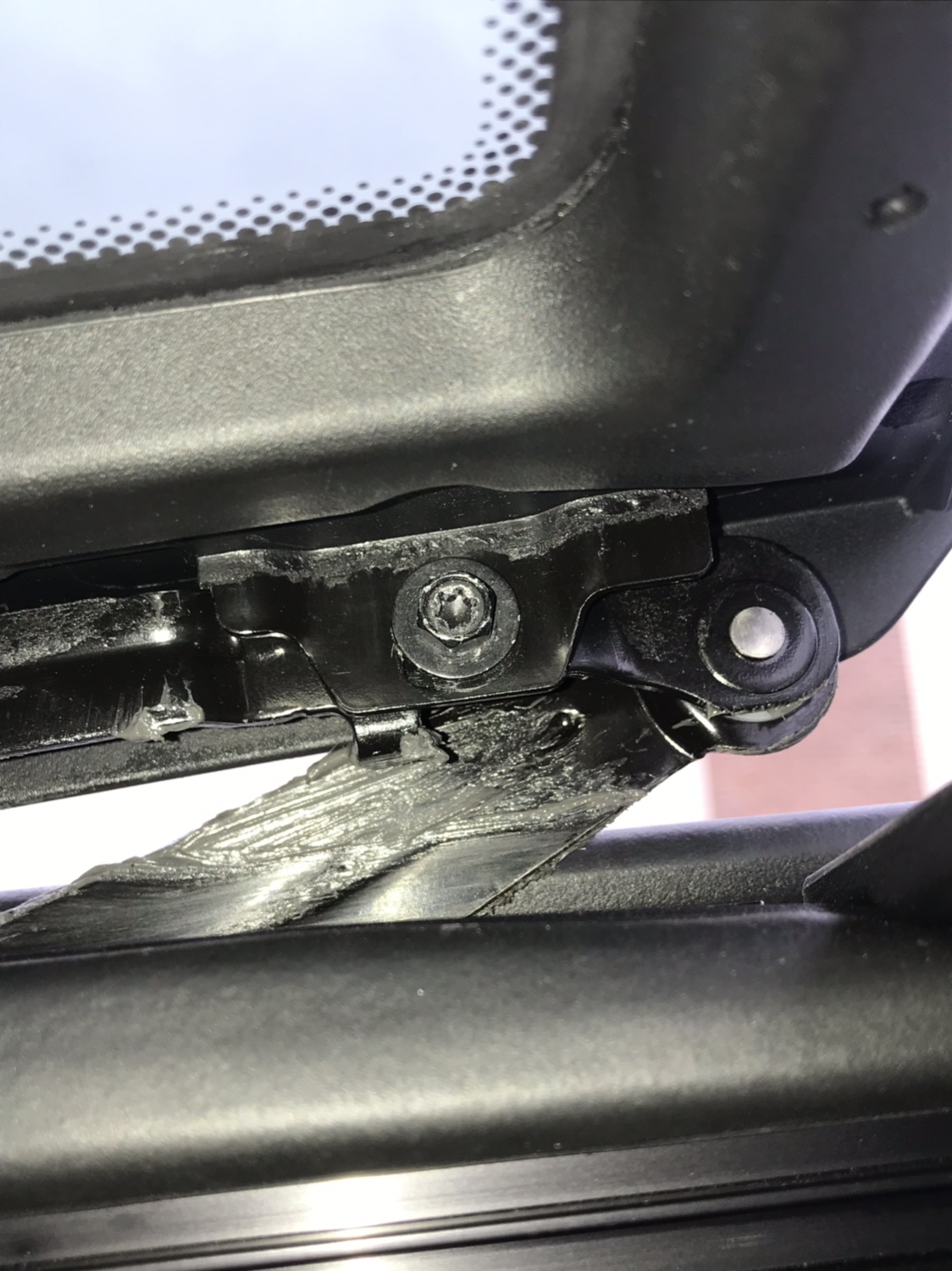

So i ended up just trying ti fix it myself. Only took a few minutes. I got a T-25 and loosened the bolt in the picture below just abit. I then push down on the sunroof and re-tightened it. It is much better now sitting almost flush.
Hope this can help someone else out if anybody is having an issue.
Thanks for everybodys help
