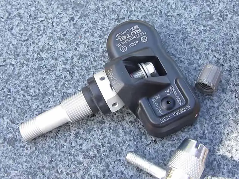

I would occasionally have just one tire driver side pressure sensor stop reading showing “—“ and shows “service tire pressure system” message. Once I turned off the truck or driving at lower speed, it would go away and wouldn’t come back up; if I replace the TPMS of that particular tire this will be fix?
Signs of a low battery, does it follow the tire if moved to another side? If so, then a replacement is in order, they OEM ones are cheap, the batteries typically last 5-10 years.
2011 Honda Fit that still has original TPMS (1 replaced - road damage) but only has 20K on the odometer.
It could be the low miles. I think the Fit's batteries are also rated at 5-10 years.
The systems that don't use batteries, like our Toyota C-HR uses a difference in wheel rotation to determine a low tire pressure. Funny thing is, I like to see the actual tire pressure so I use an aftermarket TPMS on that car, which requires me to change batteries on it every 2-3 years lol. Luckily they are stem cover sensors, so I can change them in a minute.
Hi the problem its only in one tire the other 3 dont have any problem; funny thing at this moment the 4 are working i order a replace OEM sensor and replace the one with problem so as you said will be a battery problem,,, the dealer want to charge me $250 usd just for check and they dont want to advise if the change of tire sensor will fix this issue
Never use the dealer while out of warranty.
Discount Tire / American Tire offers free TPMS check, which includes scanning all 4 of your tires, checking batteries in the process. They will do that for free, maybe do that first before going any further, that way you know it's a sensor issue.
If confirmed, you can buy the sensors online, they are cheap $15 or so each, then go to Discount Tire / American Tire, they charge like $20 or so a tire to switch them out. Or they may even offer you OEMs for cheap as well.
Thank you I will do and share the update
New update;I just changed the sensor; and now it shows me that it lacks air, how many miles do I have to drive to get it to mark correctly again?
The longest I've seen is 10 miles, usually after a rotation. Was this an OEM sensor installed by Discount Tire?
