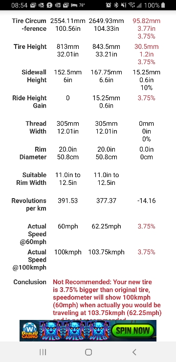

Im going to be getting 20x12’s soon and i want the ridge grapplers and ill have a 2.5” motofab so my question is i have the factory 18’s with the crappy goodyears on and they are a 32.1” tire should i go with the 305/50r20 grapplers since they measure 32.1? or the 305/55r20 ones?
Are you going to reprogram the speedo?
Here is a comparison 305-50 is the first column 305-55 is the second colum
probably not thats why i was thinking of going with the 305/50 but was just wondering what everyones opinion would be
