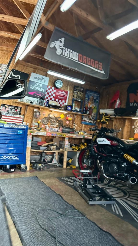

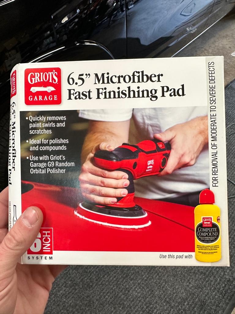

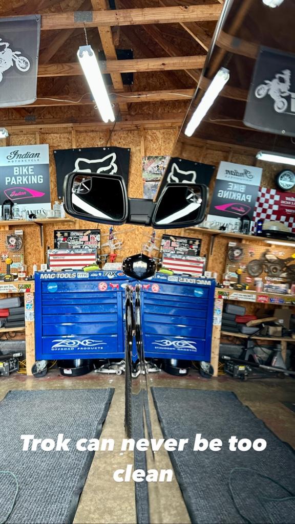

I had some decent swirling from a winter wash mishap. I did two runs on the truck. Used this pad and compound. This is before coating or wax
Looks amazing! I love that Griots Complete Compound. I have brought several motorcycle fenders and gas tanks back to life with that stuff. I know this thread is specifically discussing Diamond Black Crystal, so I don’t want to take it too far off course, but I have had awesome results using that compound. Always keep it in my lineup.
I've had good luck with griot's compound. I did find that it left paint still a little dull though. I followed up with a lighter polish and that brought it back. All to be expected though when using a compound.
