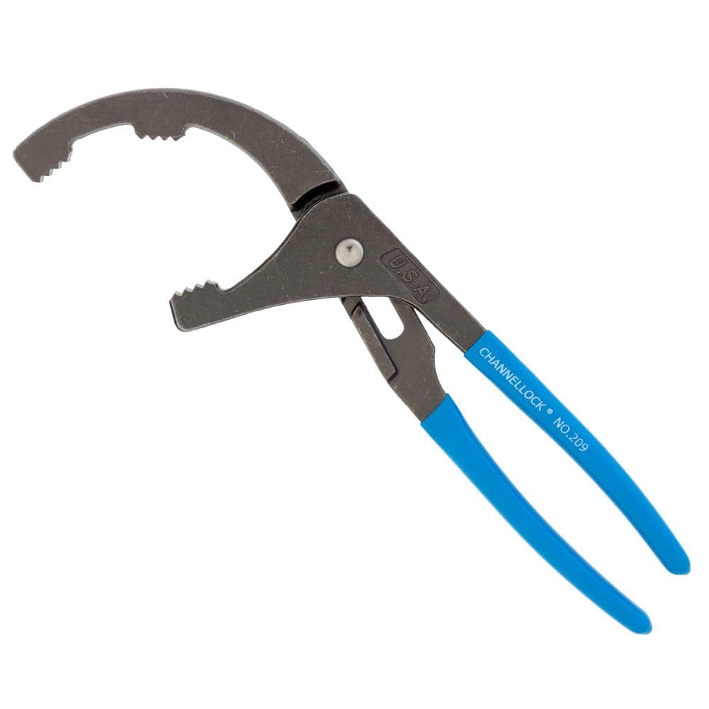

I had success with this type oil filter wrench.

My first filter change was rough. The first usually is, but this was unusually difficult. Made more difficult by the 4x4 equipment in the way. Would have been easier by far if a 4x2. My truck was built only a month before I did the first oil change. So it isn't like it had been sitting for a long time. They really do crank 'em on at the factory. I tried several devices, ended up using a pliers type of filter wrench. Smashed the filter up real good.
