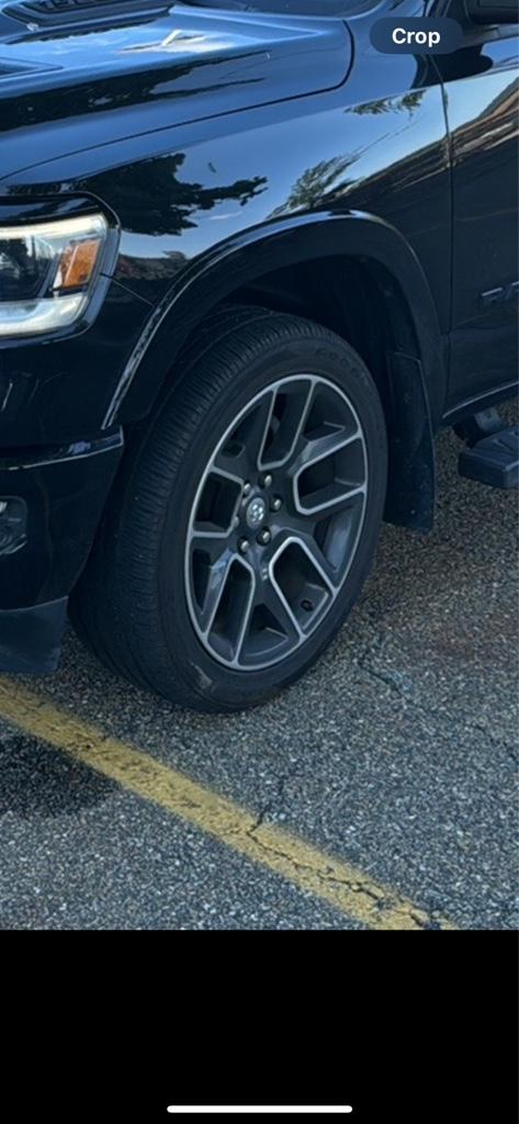

Hey guys so I need help looking for new tires on my Laramie 2019 night edition with 22” rims and I have
No clue what to look for when it comes to size and all. Today I hit a pothole that blew one of my front tire. I had 40k miles on them so I rather just replace them all. I want something all terrain and a little beefier than what I have now. I also have no clue on what sizing to look for. What would be the max, size wise to be safe that it will fit and not run and have issues. My truck is stock with no lifts or levels. Am I better off going into a tire shop or buy online ?
Need to know what options will fit Laramie night edition 22” rims for all terrain tires
you can put in your make and model and it will give you all the options.
If you like the stock tire feel you will want a highway or HT tire in the same size as your oem ones. If you ONLY want AT tires, once you put in your make and model and it shows you all the tires..on the left side you can select to specifically only see AT tires. Some good daily driving oriented AT tires are firestone destination at 2, yokohama geolander g015, and falken wildpeak at3w.
You can look at the side of your tire and see the exact size of your tires if that helps. it will be something like 205/70/22 116T (just an example, not the real thing)
