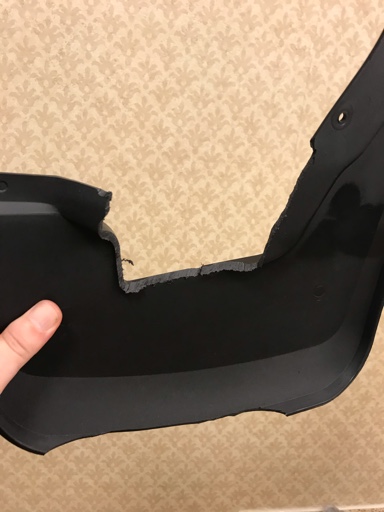

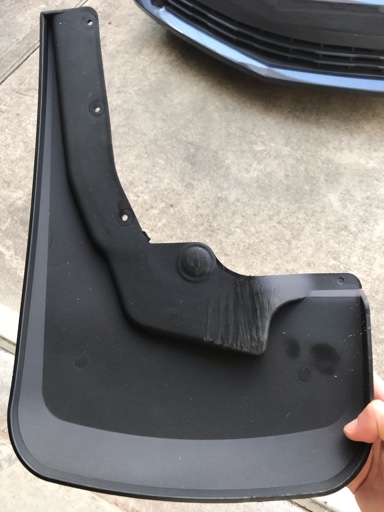

Front: definitely required modification! Put them on and tried to heat gun bend it back. Didn’t work. Went 200yds and that’s all the rub.
I then decided to chop them to fit. If I don’t like the results, I’ll just get another $50 set.
Made the mistake of asking google how to best cut ABS plastic. A dremel? No Way! Went and got one of these:

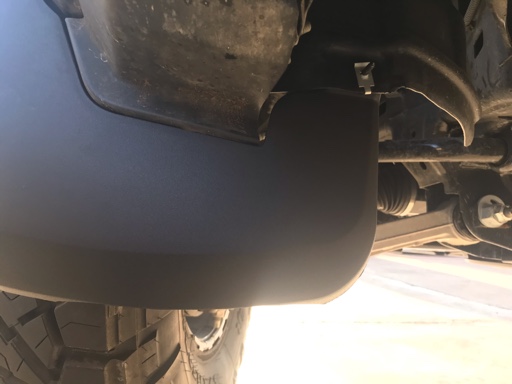

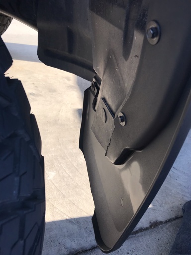

Works fine. Ugly edges, but gets it done and easy to go around the weird corners on the flaps. Doesn’t get hot on the low setting. I removed the bulge that goes over the old flap with the dremel. Then I used a pocket knife to cut the leading edge off of the lower interior portion of the flap.
Mounted them and all appears to be good. Way better than gravel battering the paint!
