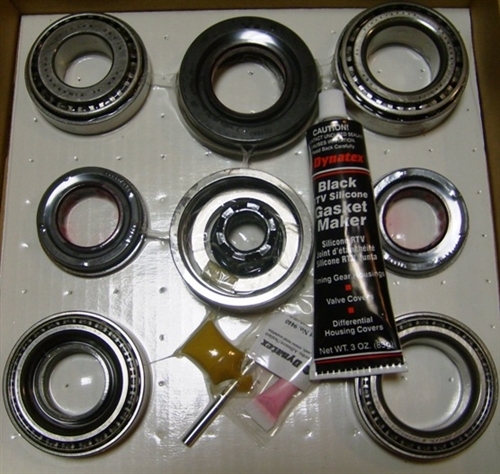

I believe these are the items i got. They also offer a master install kit, but i opted for the basic install kit because my truck i low mileage
