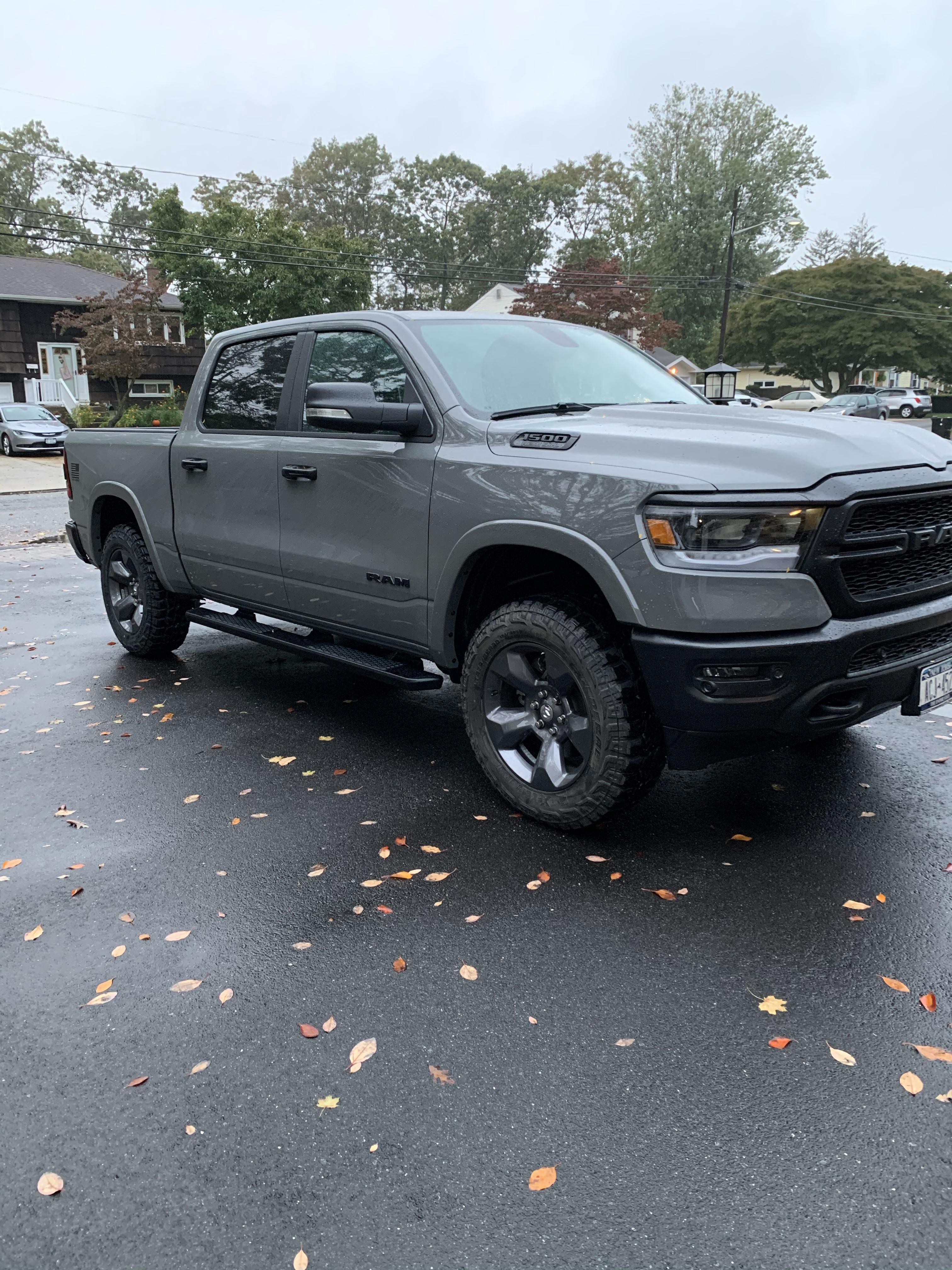

275/65R20 with no issues. Basically 34x11.
35-12.5/20 nitto ridge grapplers on stock rims with front leveling and very minor trimming. Just FYI

Is that what your running? Any pic's
Yes that’s what I’m running

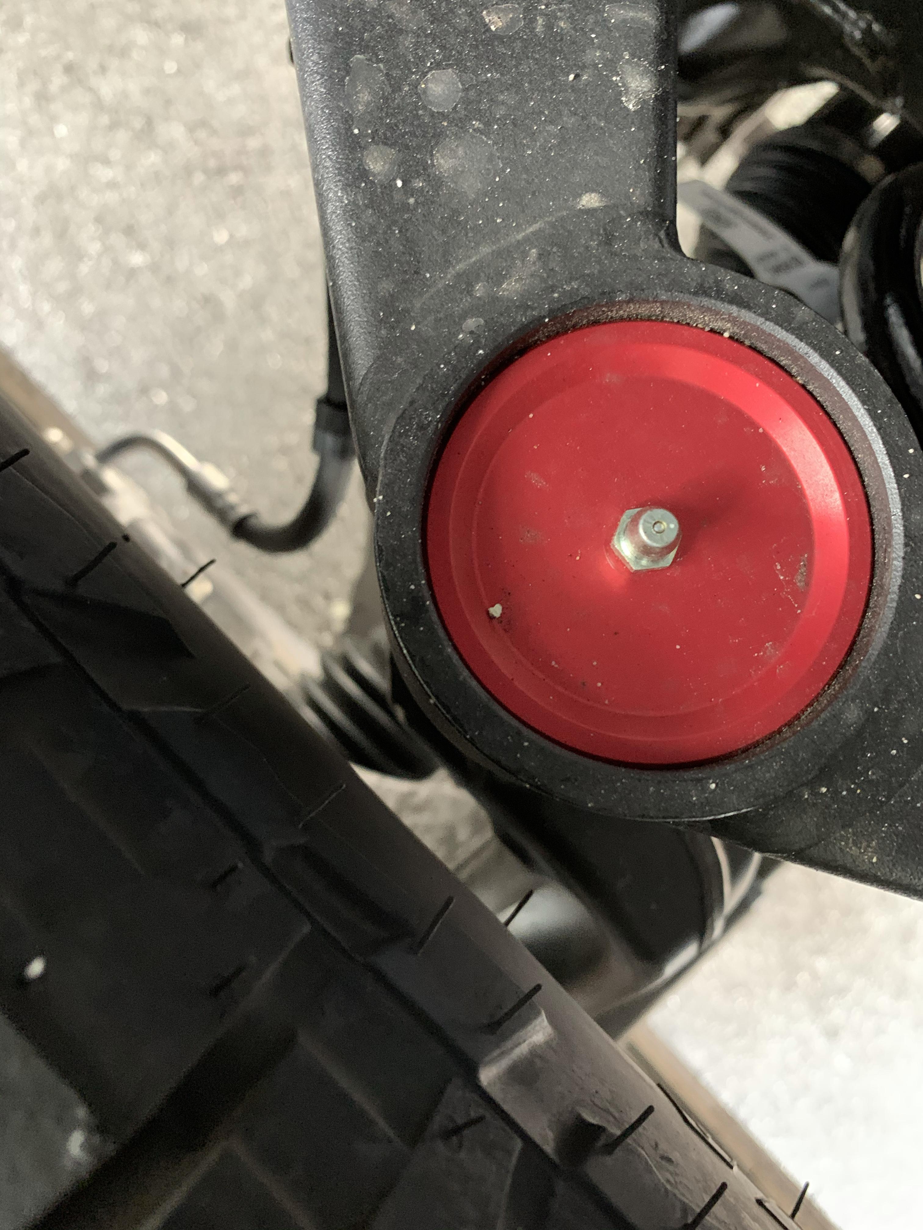

Here’s 275/65’s on stock rim
Pretty damn close to the UCA’s. You would probably need a spacer and then have to trim some plastic.

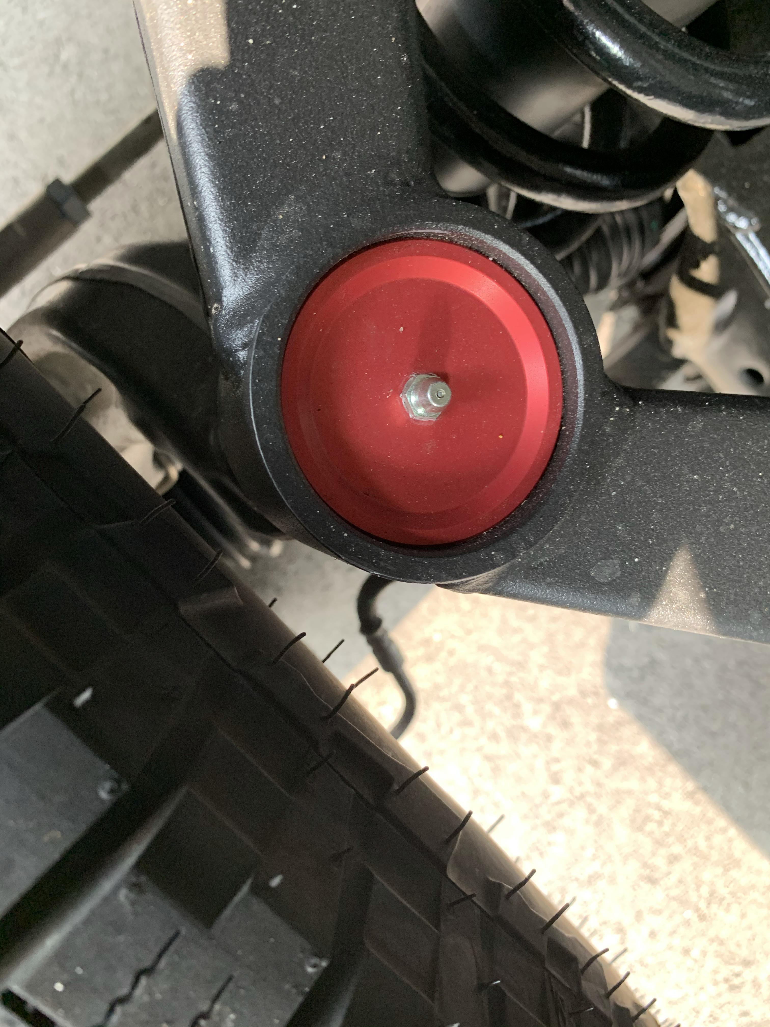

35x12.50R20 Thunderer Ranger ATr $725.00 ride like a dream, no spacers required for UCA’s

This is on stock BTS. Are these E rated and how is the ride with them they look great. The stock BTS rides perfect for me but will eventually need a better tow tire. My 14' bighorn had General Grabber ATX and will go with this brand.
No I’m leveled 3” and yes they are E rated. Ride is awesome. Still trying to use to the quietness of RT tires.
