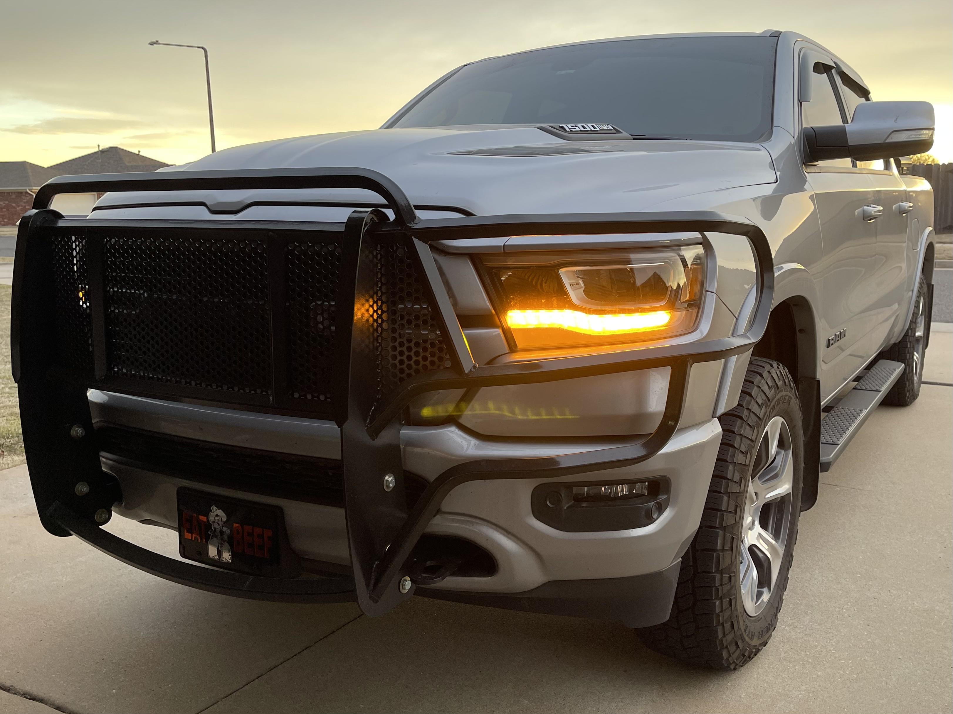

Another option is disabling the signature lighting and setting the amber turn signals as the DRL location. This creates a unique look that really sticks out IMO.
That’s what I did.
I just changed mine to the amber I cant believe how much light they throw!!
Almost too bright at night. I like the daylight setting. Mine is currently set to both on Tazer but thinking about doing daylight only.
