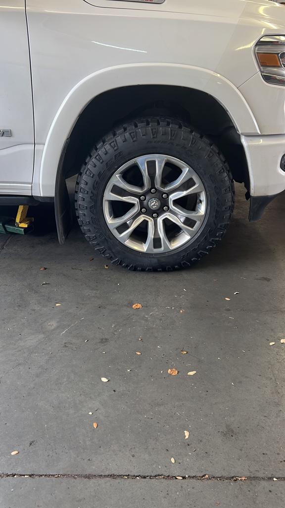

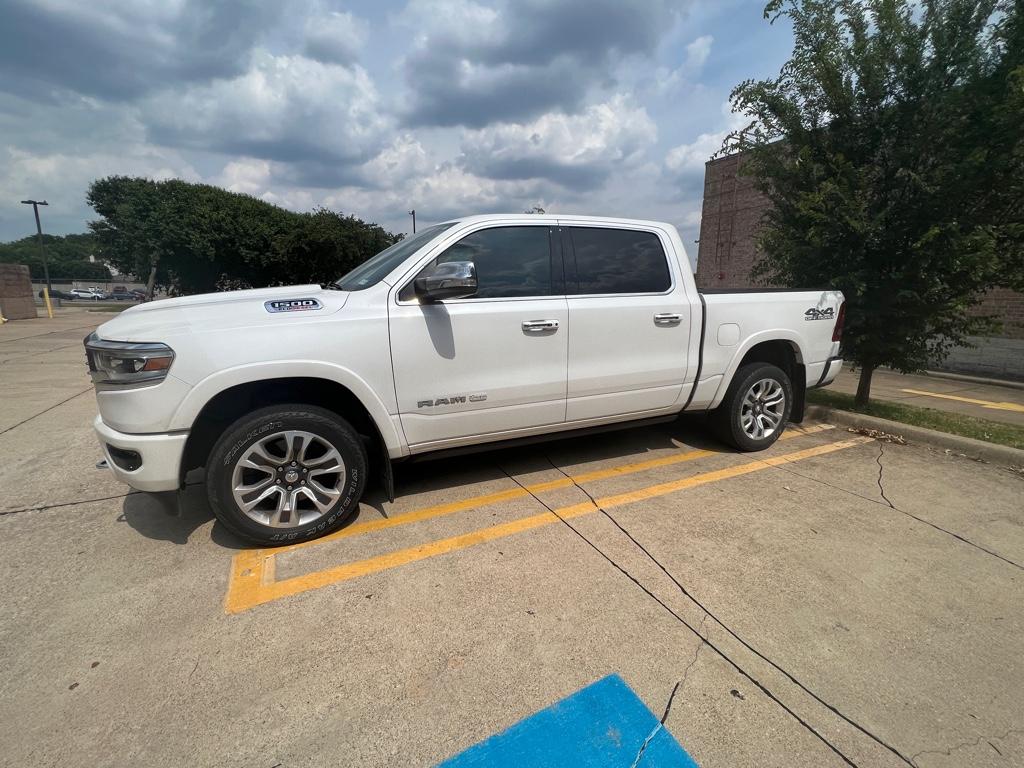

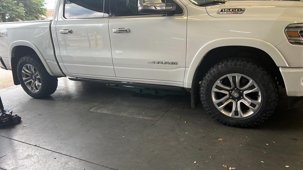

I ended up doing:
Duratracs 285/60/20
Factory (non-air) Suspension (offroad package) - No rubbing whatsoever.
Truck still clears 7” height barriers for parking garage at work !
