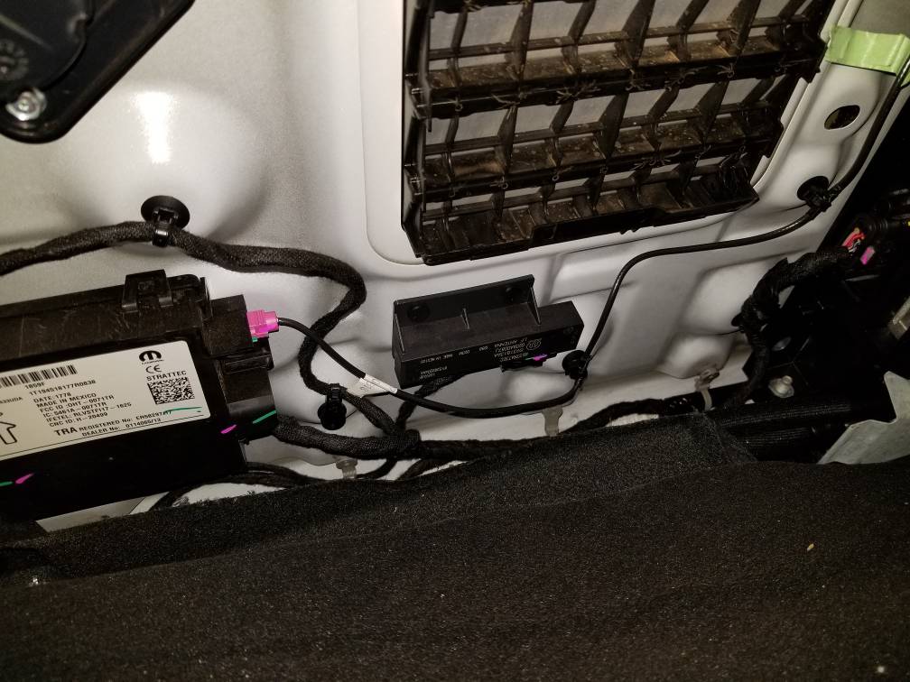

Have the dealer test your RF module; this module also controls the LF function of fob proximity detection.
Thanks. Where is that module located out of curiosity.
Easy enough to get to.
I was having the same problem. The cable with the pink connector had come off. It's been flawless for a couple of days now.
Thanks for picture! I'll give that a look. I did some work on that back wall so might have bumped it.

My key fob would only work from the rear doors back, not from the front. And the truck would only start with the key fob in the back seat. If it was in the front the truck would say "no key fob detected".
