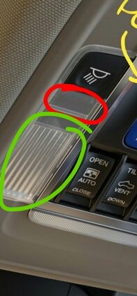

My dome lights were working and then I adjusted the brightness on the interior lights while I was driving last night cause it was very bright. Ever since I did that, the dome lights aren’t working anymore. I’ve read the thread and tried everything and nothing works. The lights do work when I manually press the specific light button for each, but not when the doors open.
This was the post that turned on the light for me, literally. I just got a 2022 Ram 1500 Bighorn a few weeks ago. I never really noticed the switch that shuts off the dome lights completely.
I turned on the map light briefly on the way to work this morning and when I got to work and opened the door I got nothing but darkness. Turns out I accidentally shut that switch off. It turns off the courtesy lights on the mirrors and tailgate and the cargo light also.
I walked away from the truck thinking I was going to have to start checking fuses or possibly had some kind of software problem, because the map lights, cargo, and tailgate lights all worked when I turned them on with their dedicated switches, but the dome light above the rear seat didn't work no matter what.
I've never owned a vehicle with a switch that completely disabled the dome and courtesy lights like that. Now I know to not panic if it happens again.
