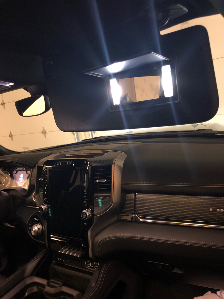

The vanity mirror lights that came with the kit are wayyyyy too bright haha... so much glare that it defeats the purpose. Will have to pop those covers off and spin the lights around more.
