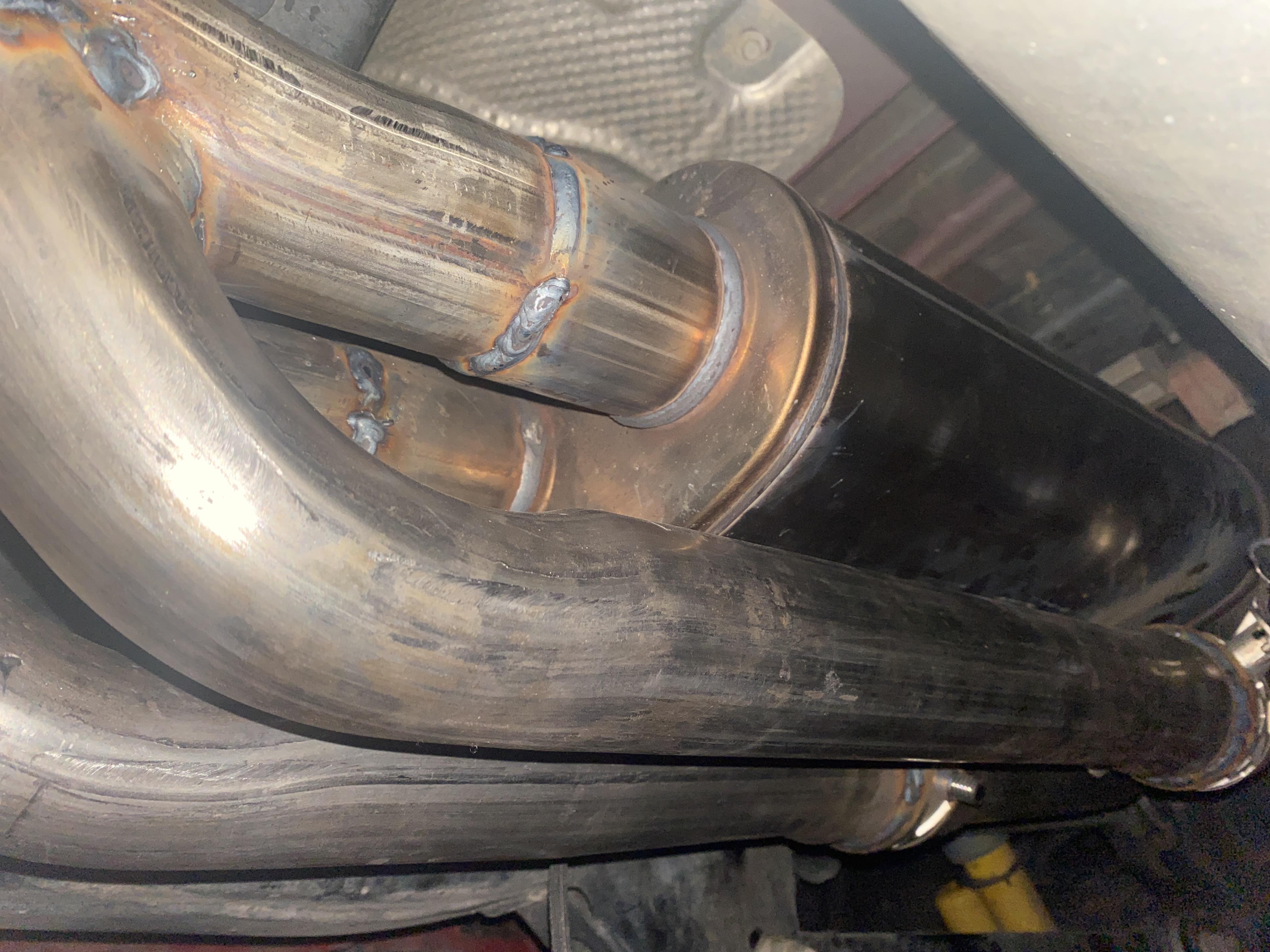

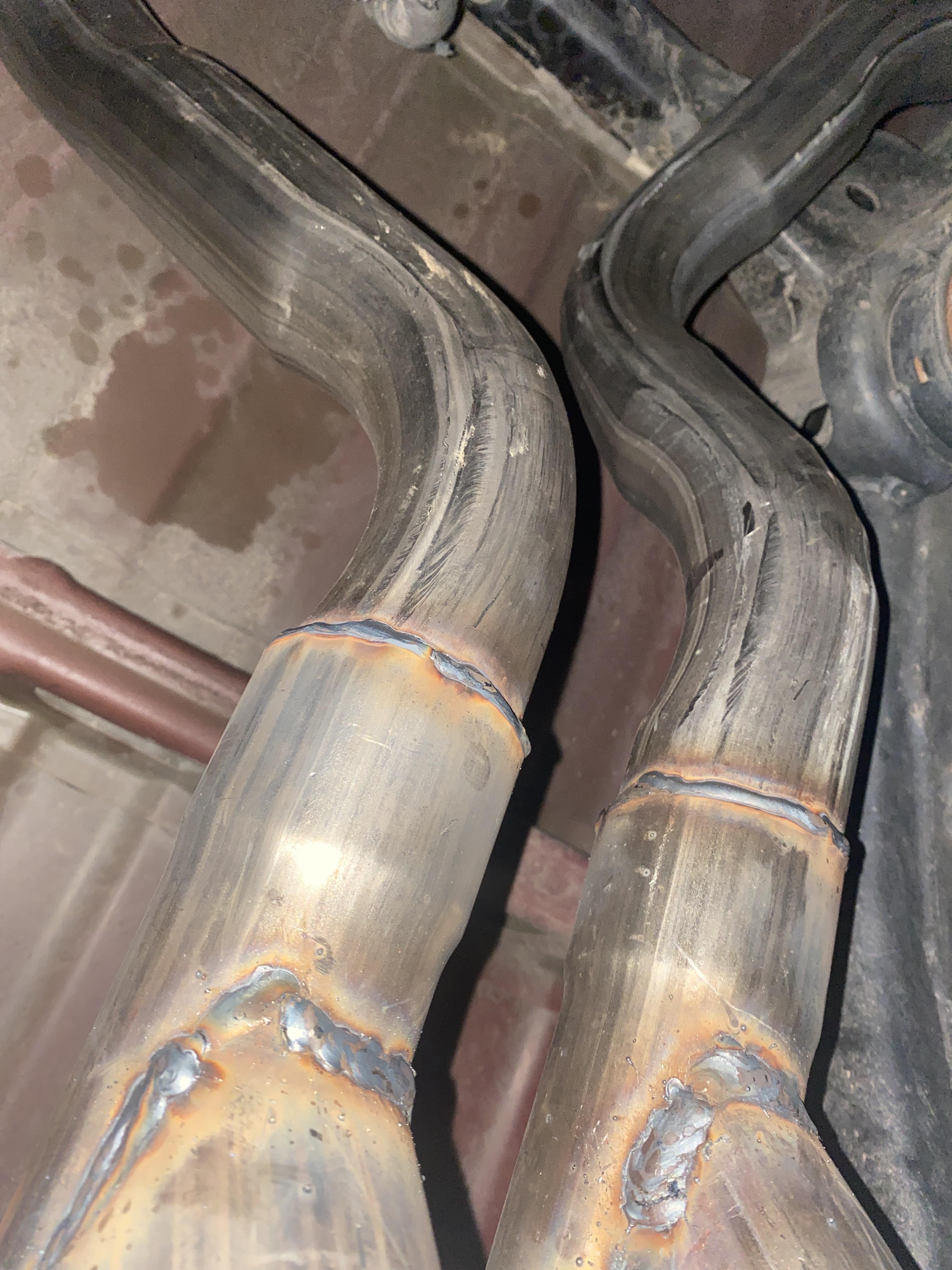

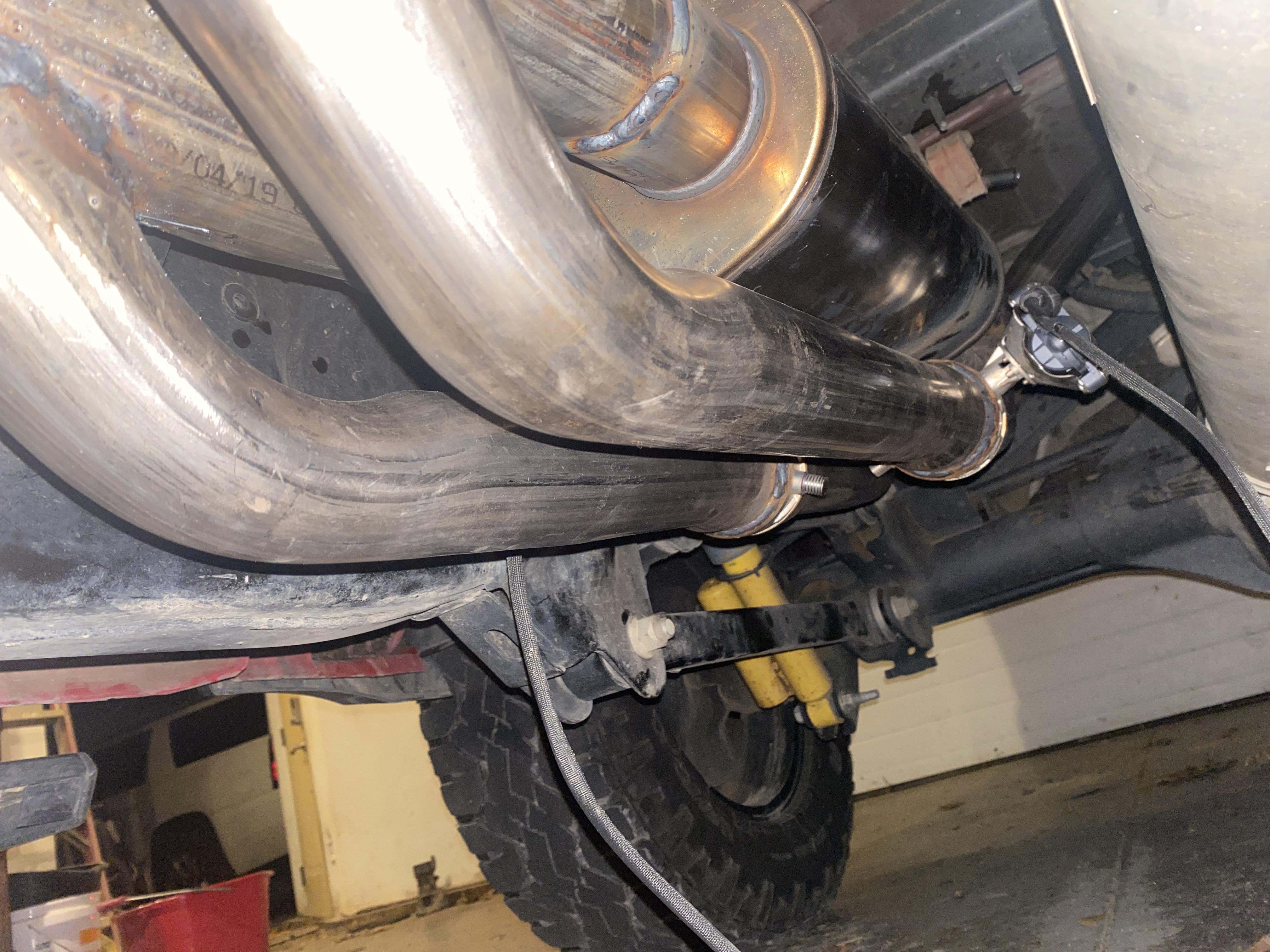

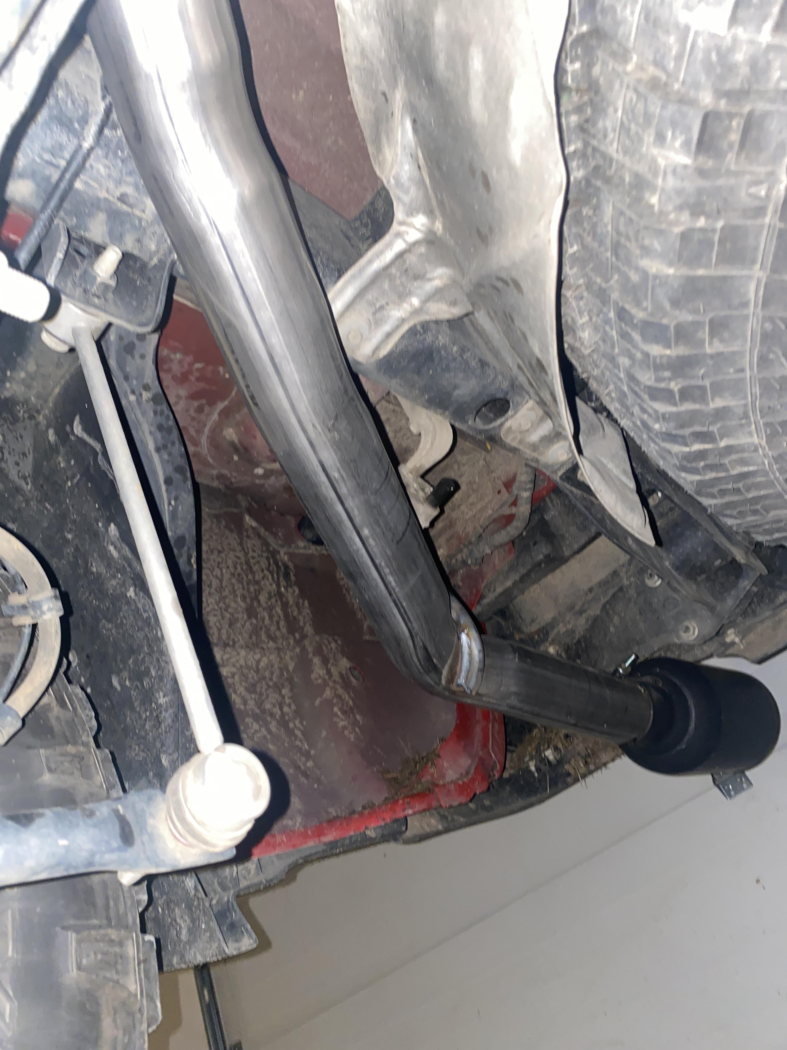

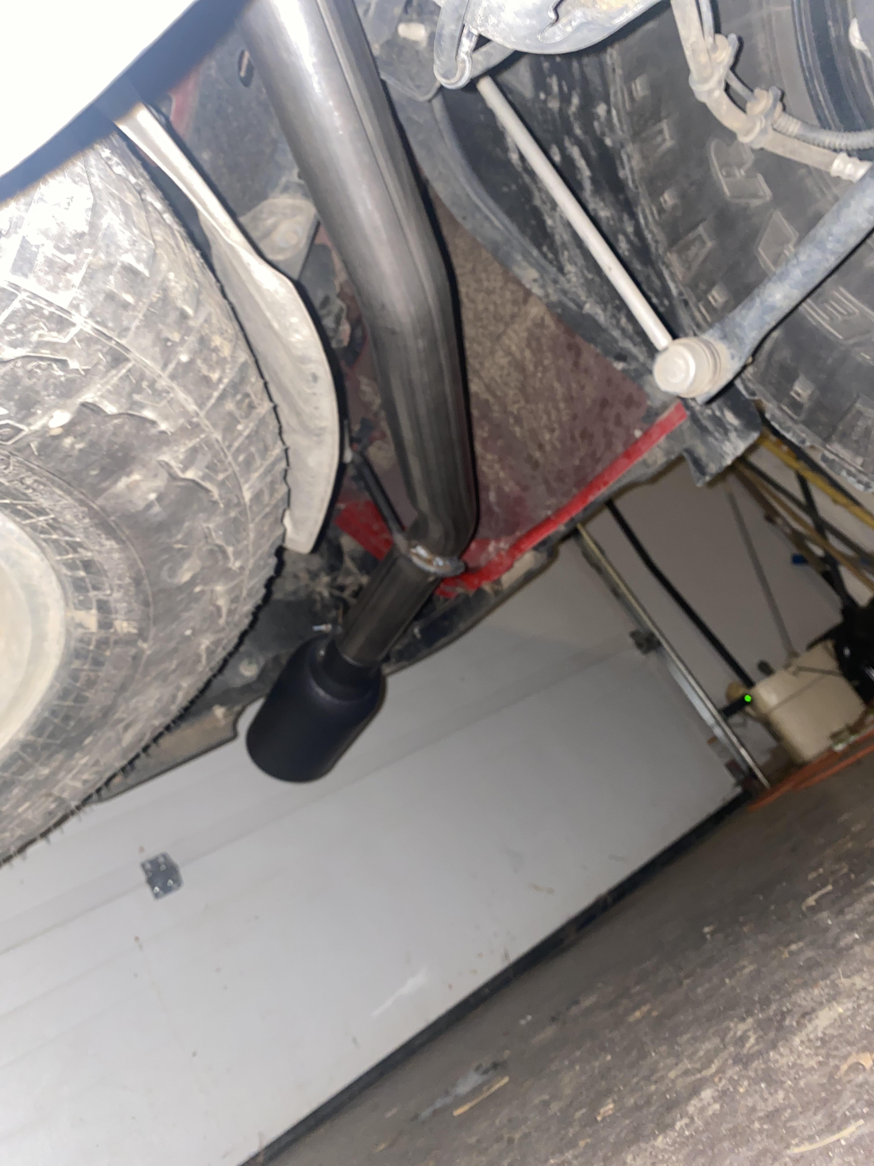

True duals all the way back

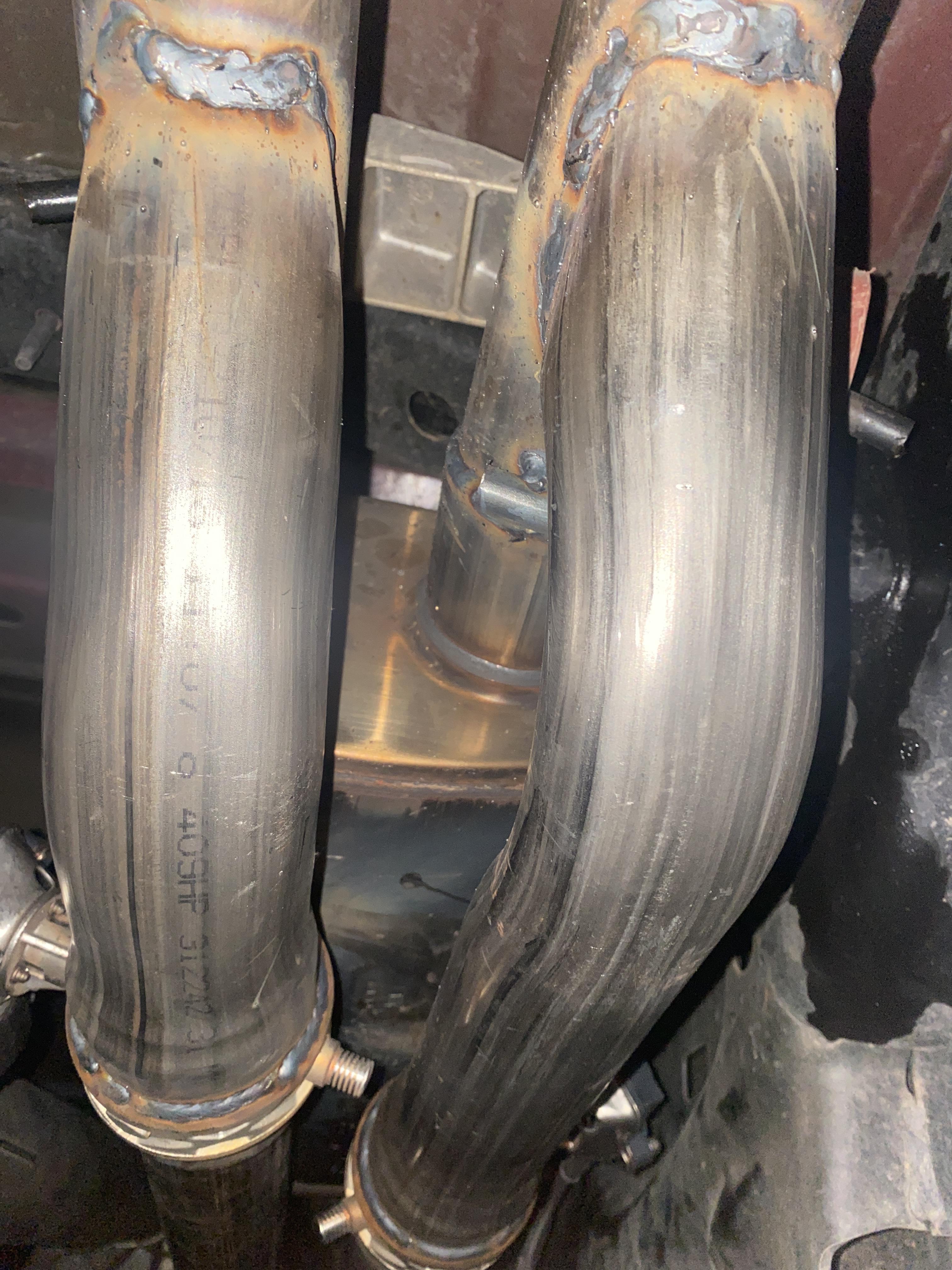

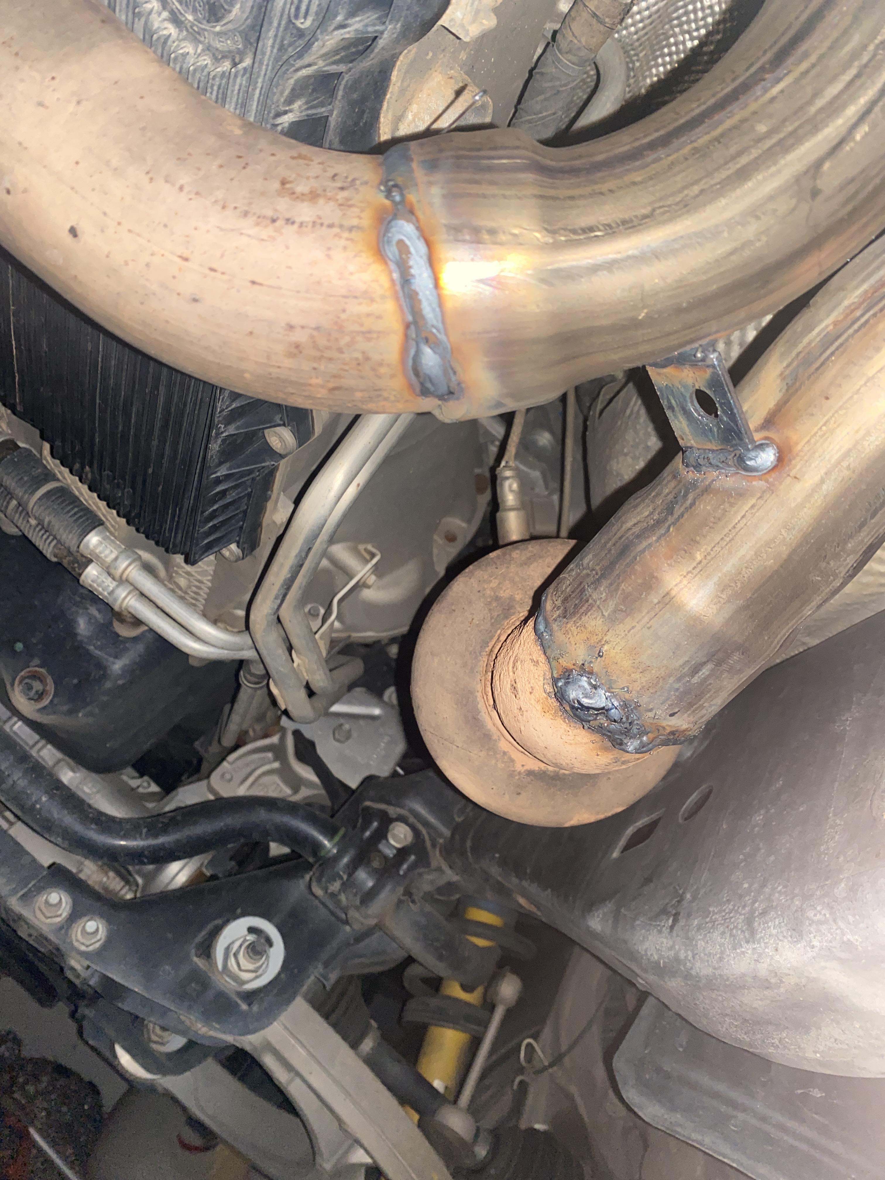

Cut the y to connect the 2 pipes for the duals and then goes into the muffler system and out into the tails

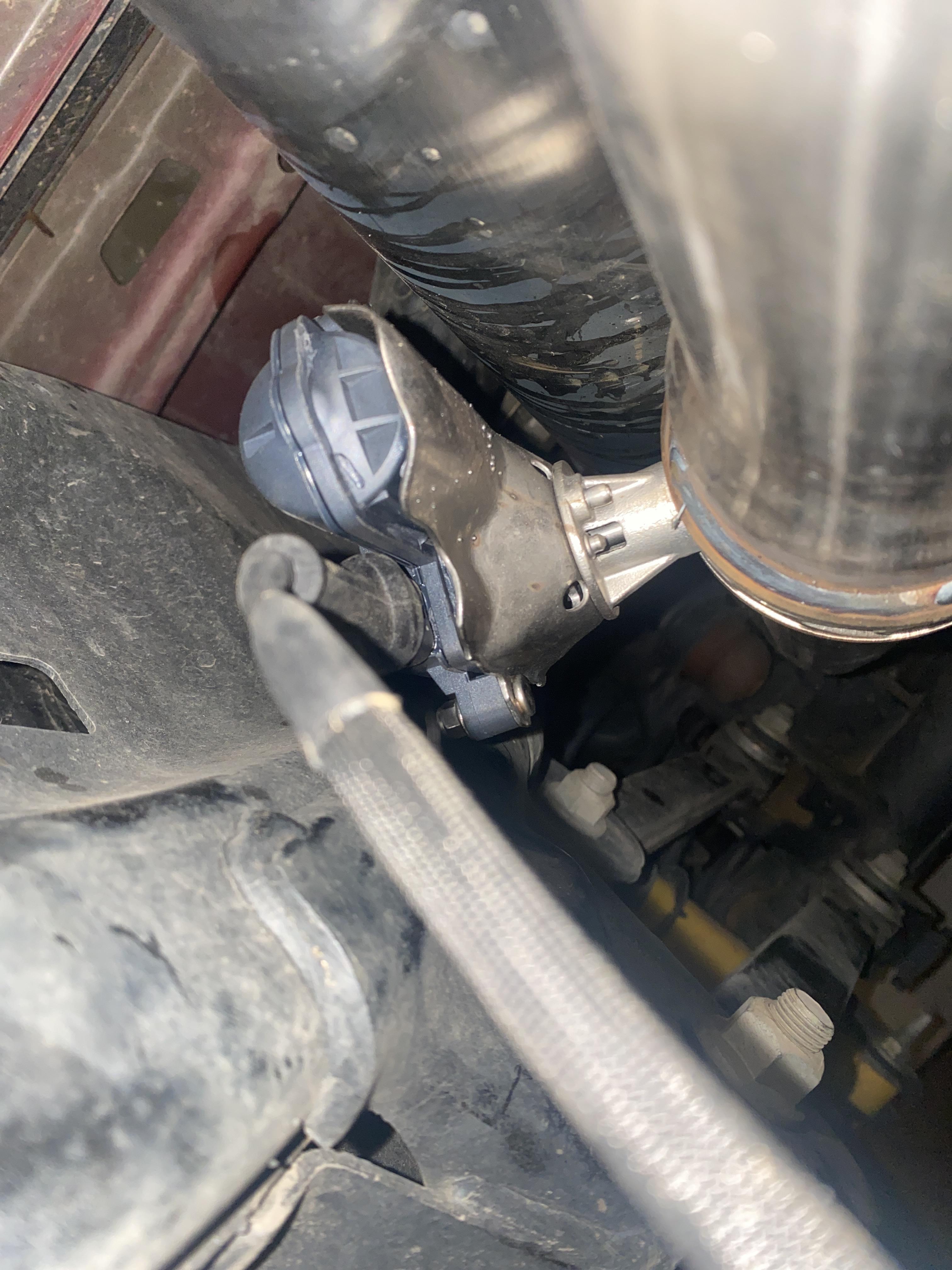

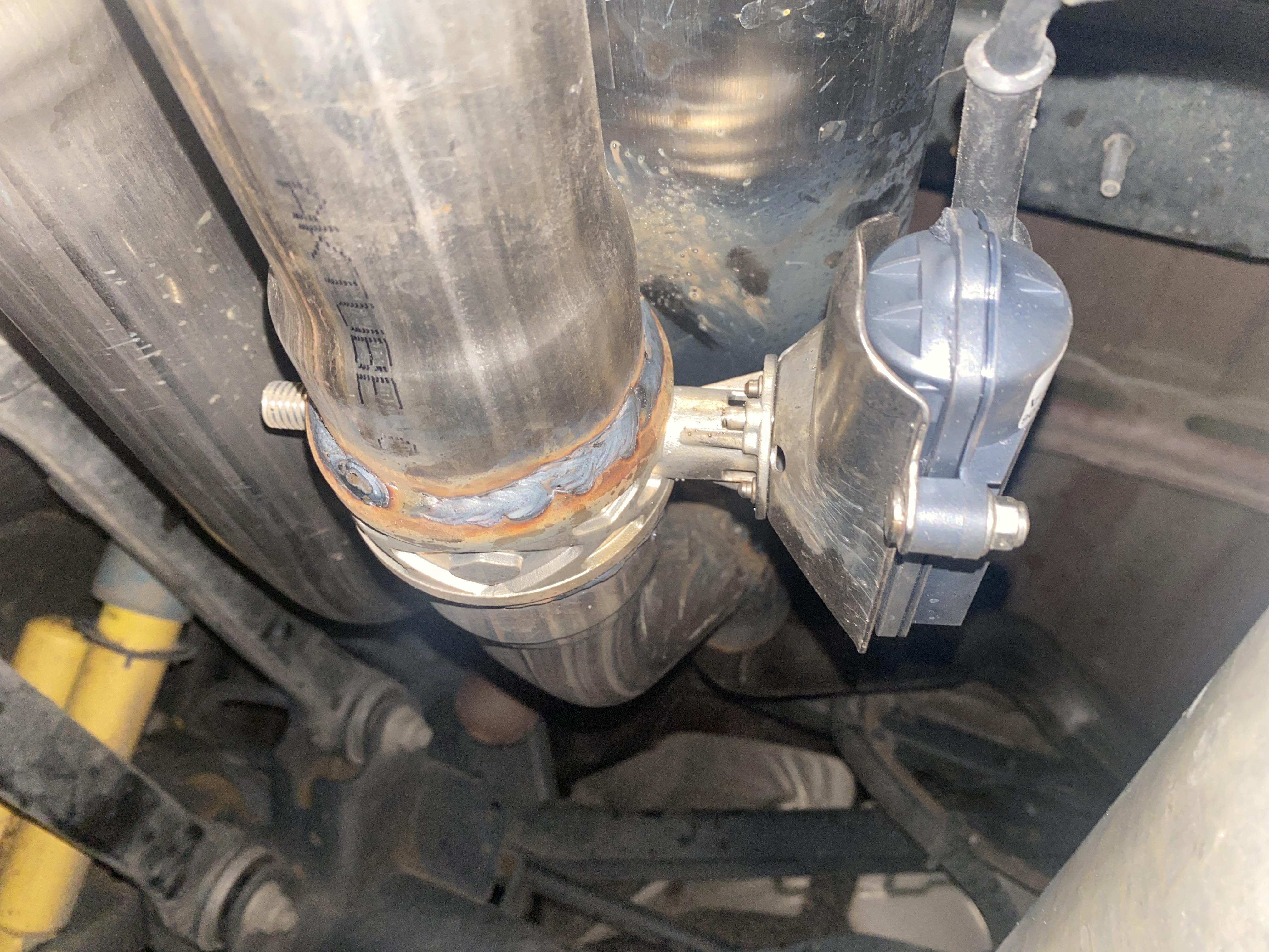

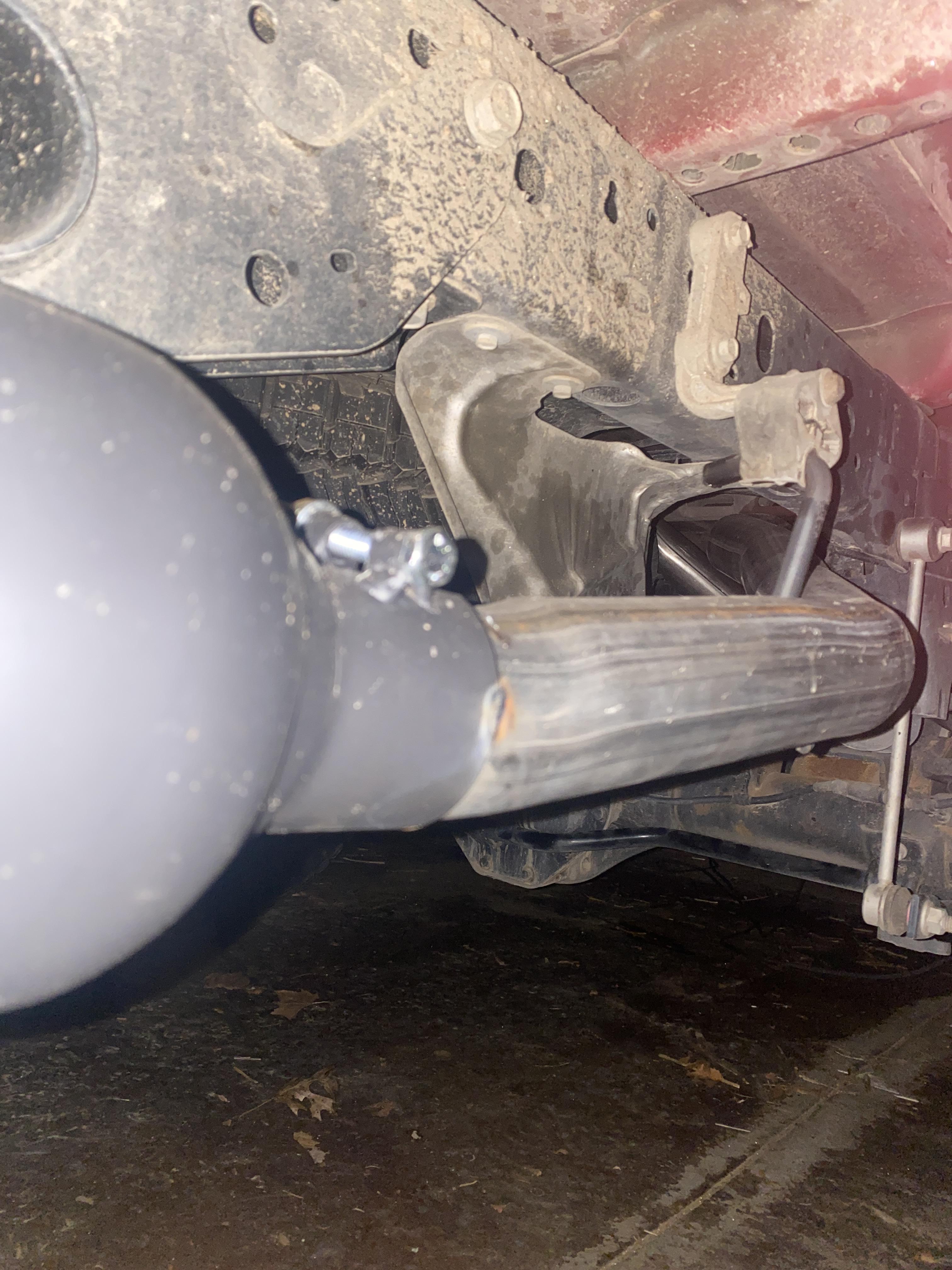

2.5in dual in dual out 18 inch MagnaFlow muffler. Used the hooker attitude adjuster https://www.holley.com/products/ex...I-ZaR6Ii-5wIVgYbACh0X7gEaEAQYByABEgJT7vD_BwE
They work just like cutouts. I basically have 2 y’s before and after the muffler on each side with a piece of straight pipe connecting then with the 2 valves welded in at the front 2 y’s to basically bypass the muffler
All the piping is 2.5 in stainless including the tailpipes

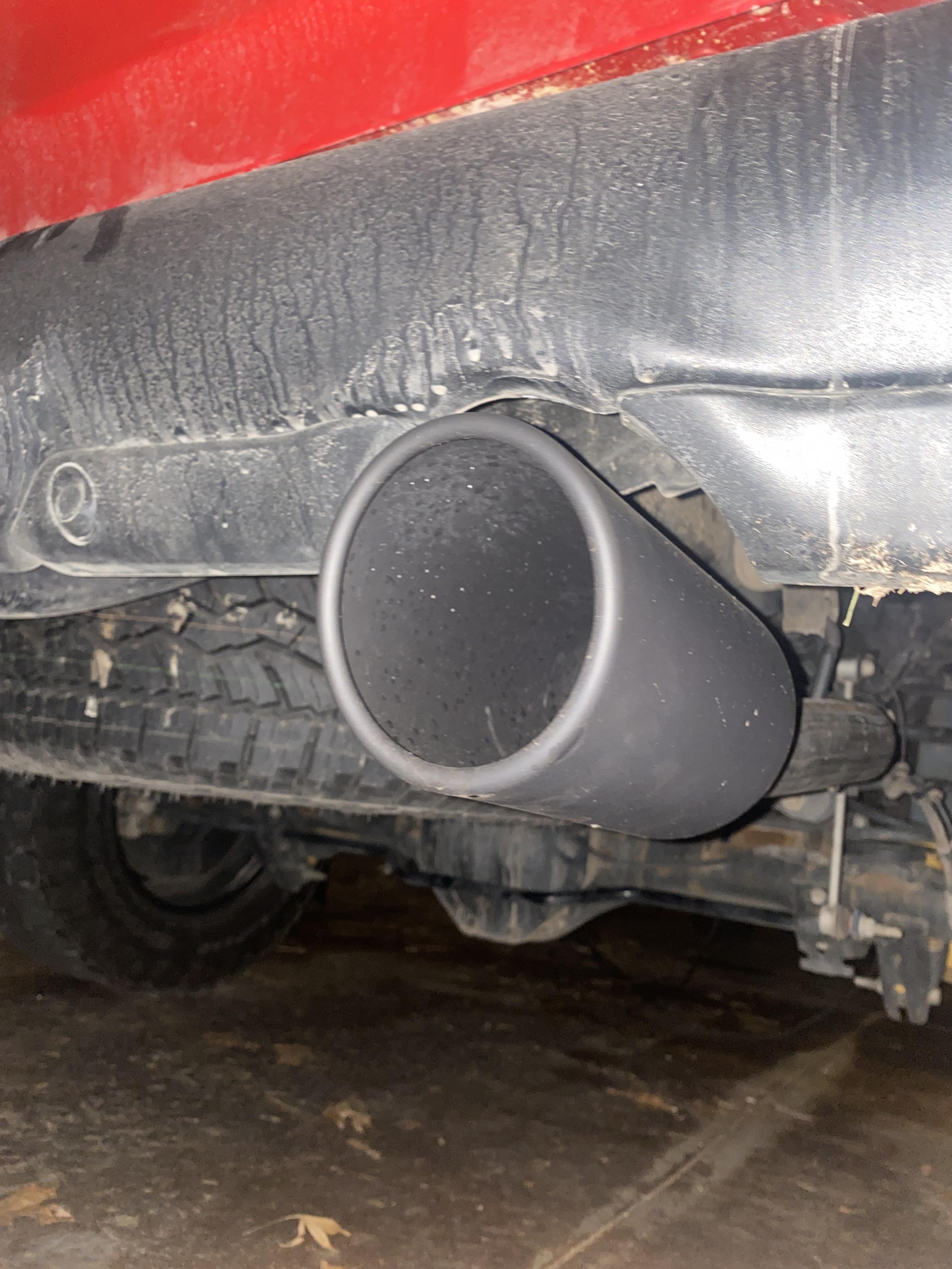

I put 5 in Gibson exhaust tips too

Thanks! I think it came out great. I had my local muffler shop do all this and they were great. I had about 8 hours in labor plus cost of pipe muffler valves and tips
Well worth it for a job done correctly in my opinion..
I agree. I think it’s awesome
How is it performance wise and mileage wise after going true dual?
Not sure yet haven’t really drove it. Just got done yesterday
Before the duals I was getting about 10mpg. Driving it for a minute yesterday it didn’t seem like it lost power. I had talked to Matt from Moe’s performance and he said that I may loose some low end torque but it still seemed responsive and powerful. I gotta drive more to tell if it picked up any power you’d think it would but I’ll have to see. The duals sound great though
