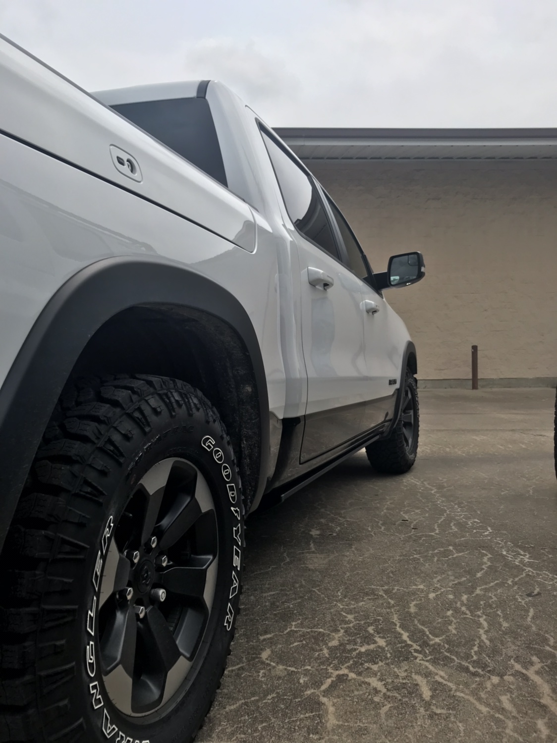

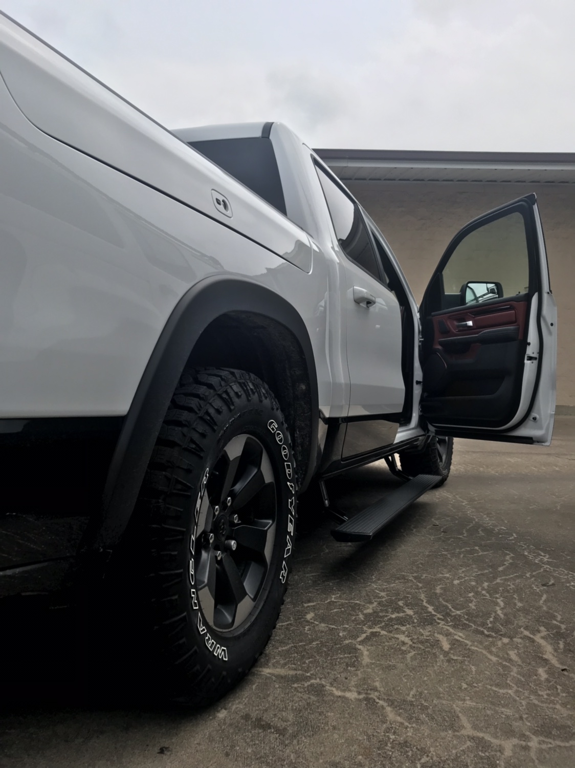

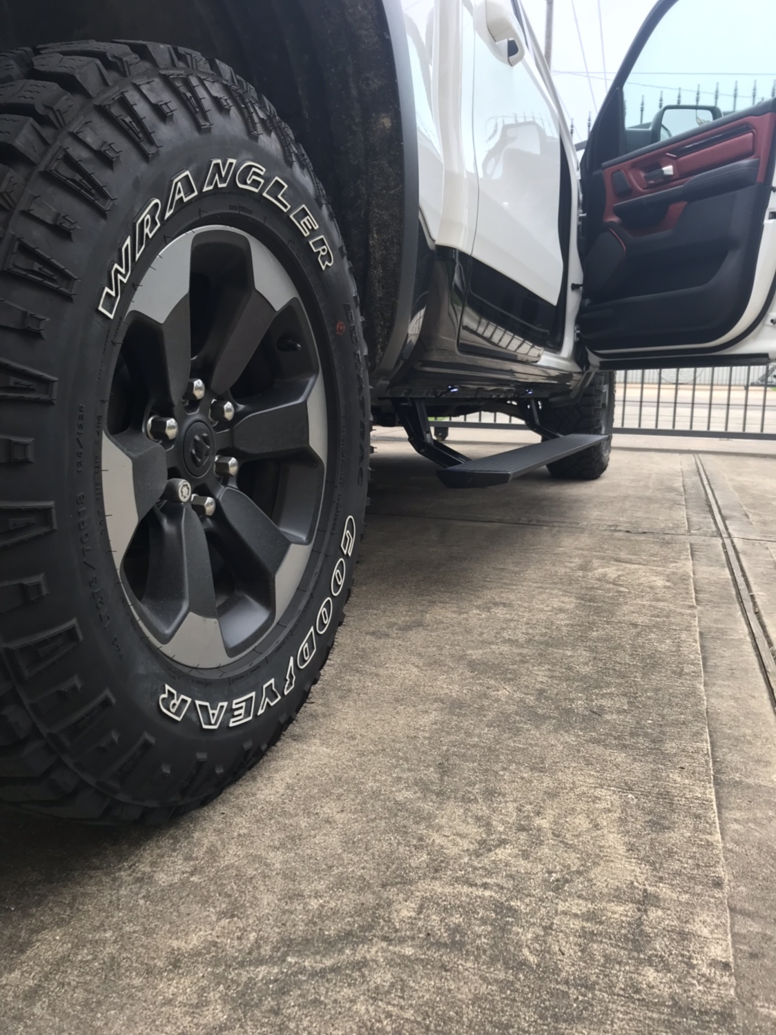

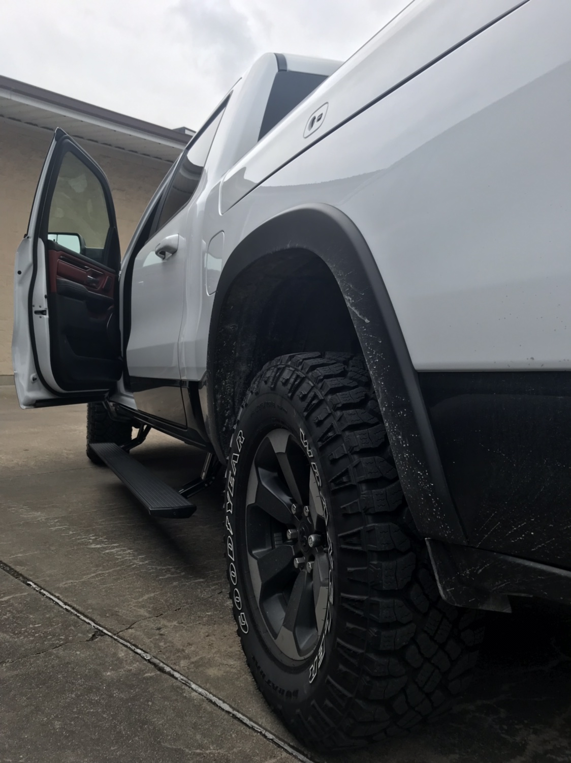

Just had the AMP research PowerSteps installed on the Rebel at 4WheelParts. I didn’t see any of these measurements anywhere else, so here they are! All stock so far.
Step Up Height from Ground
Entry/Exit: 6-3/4”
Normal: 10”
Off-road: 11”
Distance from step to floorboard: 15”
Some thoughts:
Unless you’re going BIG (over 37” rubber), no need for the XL steps. 3” lower would basically be on the ground for the factory truck.
Want to wash the truck? Just stand on the step and close the door. They stay deployed. Threw a cinderblock underneath... they hit and just kinda stop. It’s cool to have the button, but Not really necessary.
Anyway, hope some of the dimensions help. Pics are stowed, E/E, N, O/R

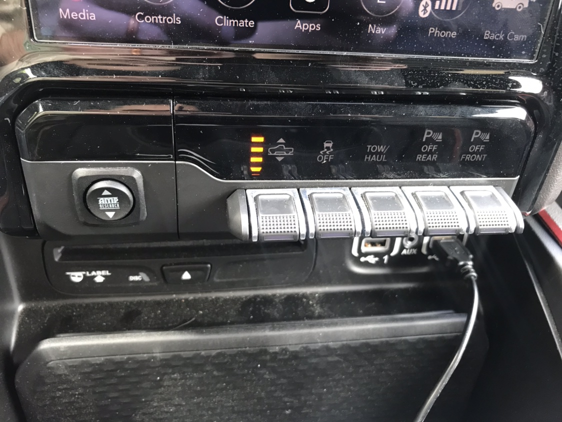

Updated: installed the switch ($35) in the blank spot where the trailer brake would be. Ripping out the 12” screen is nerve racking.

Your truck looks awesome. I just ordered my steps. I want to do an install with the switch as well. Is there a guide somewhere on pulling out the 12" uconnect?
Thanks man: this is the guide I used. Make sure to say the prayer! Search “How to Remove 12" Screen - Fixed Brake Controller” posted by Edwards
