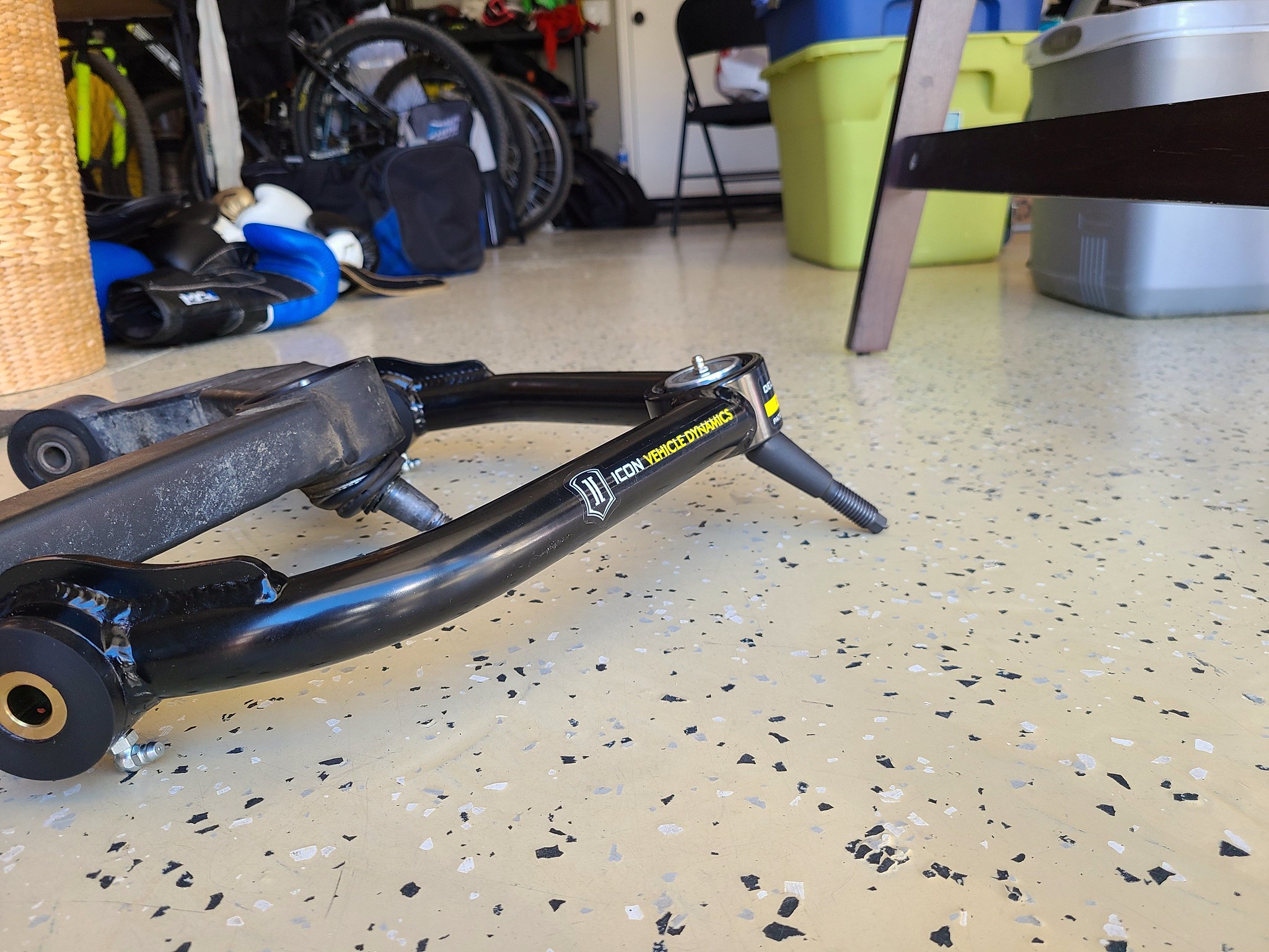

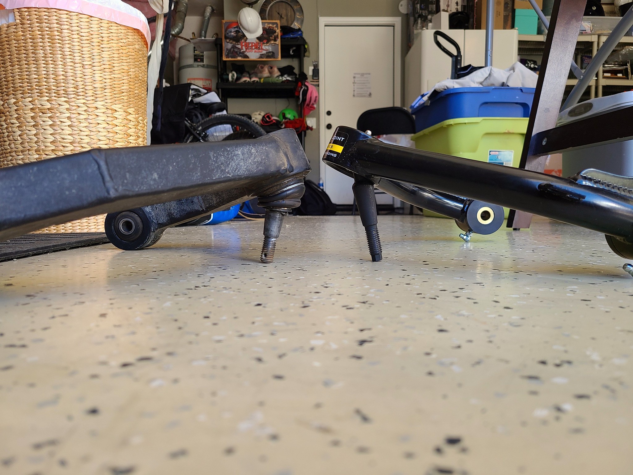

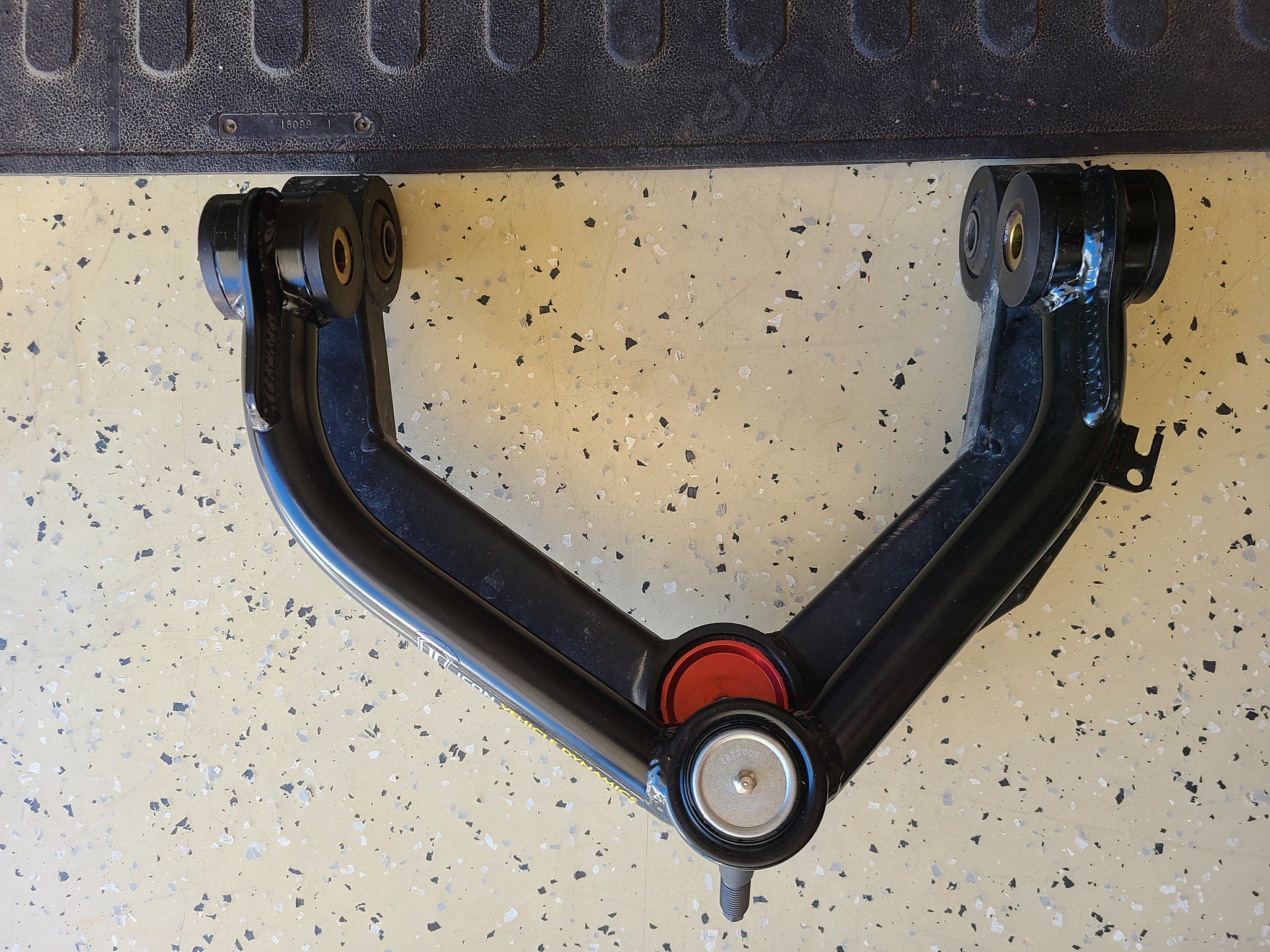

To give you an idea here is my comparo of Icon vs my old Zones
The BJ sits a different angle. i wish i coud have measured the difference, this will be max drop travel
Icon Delta Joint UCA vs Zone UCA Max Down travel by RAM RSM, on Flickr
Max up travel
Icon Delta Joint UCA vs Zone UCA Max Up travel by RAM RSM, on Flickr
and offset (both ucas have govs of caster built-in correction, Icons have a little more)
Icon Delta Joint UCA vs Zone UCA Driver side by RAM RSM, on Flickr

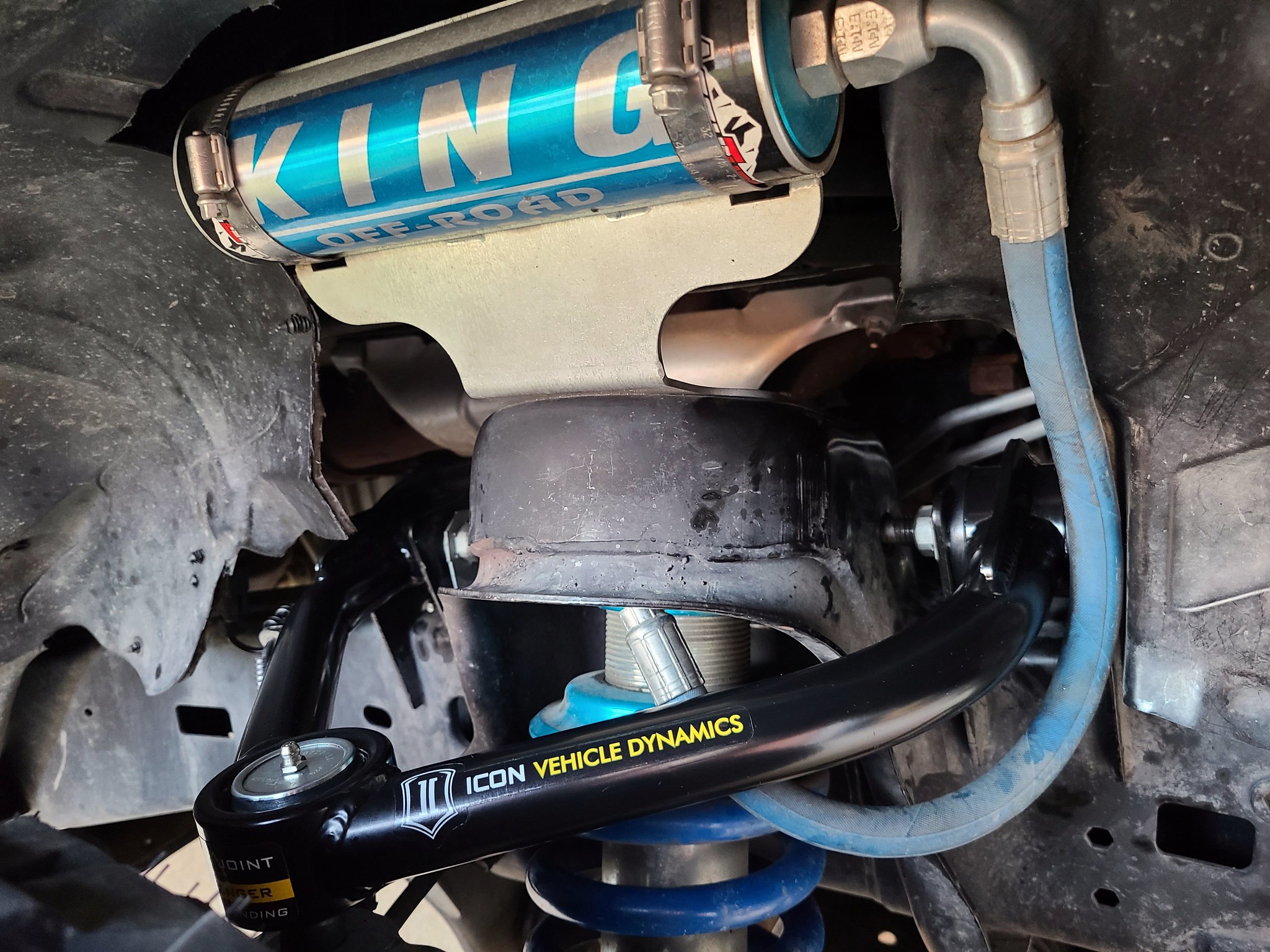

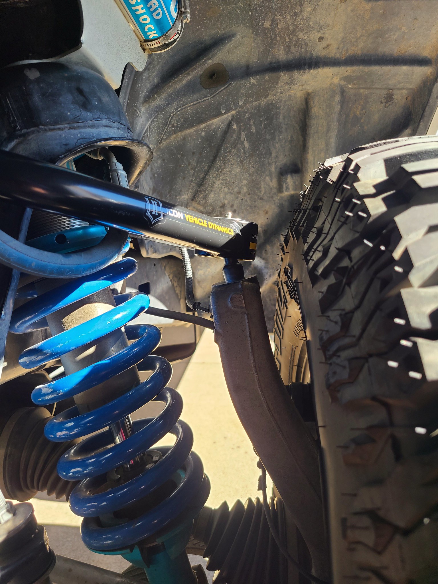

Mounted in the truck, this woud be full droop in my truck, notice the CV angle
2021-01-17_06-17-38 by RAM RSM, on Flickr
Accutune King 2.5 CO's with Icon Delta Joint UCA's by RAM RSM, on Flickr
