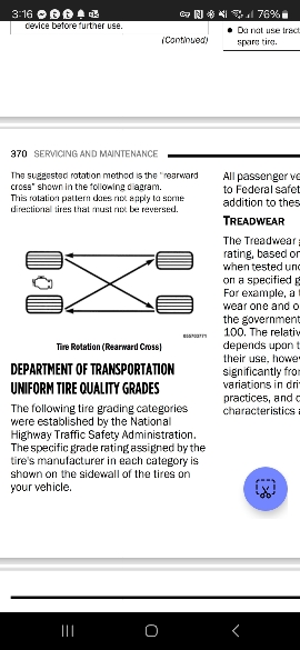

Have you checked the owner's manual?
This. And for me right now, the two tires with the most wear are on the right side of the truck. If they were using this method, it wouldn’t be so?

Talked to a tire expert I know. He said the right sides are worn because the place that rotated my tires are only doing front to back, and not crossing. The right rear wears the most because it’s the primary pulling tire. Suggested ordering two tires, put them in the back, and rotate left and right only for awhile. Until they even out.
