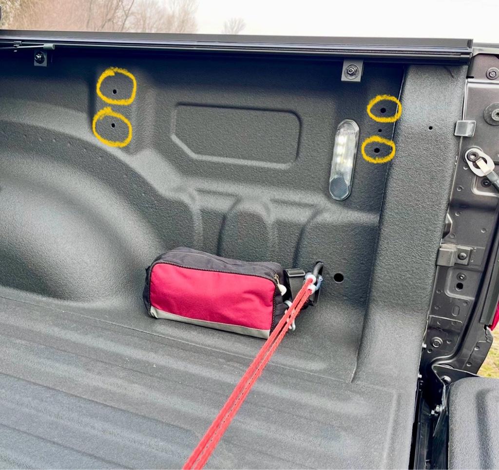

I would like to have four new hooks to secure light loads.
the problem is that I don't know how to reach the back to mount the threaded plates to invite the hooks.
can you give me some ideas please? (I don't have RAMBOX)

You use rivet nuts or nutserts to do it.
It seems like an excellent idea to me at least for fixing light things. Thank you

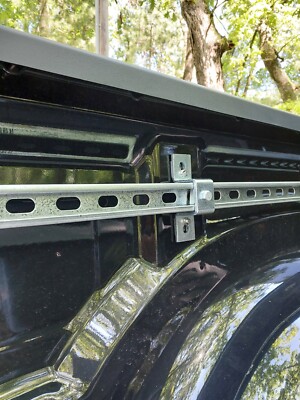

That's what the factory uses for their bed rails if you get the bed utility group option.
very interesting and cheap too! (at least in the US)
now I search on the EU market of Amazon or Ebay and.... problem solved!
Thank's all

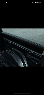

I got the ram bed rails that were posted earlier in the thread. I found them on the mopar site and tried a few different dealers until i found the best price.
