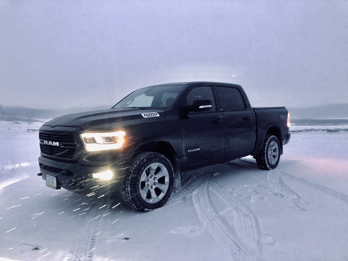

I have some recent experience living in NW suburbs of Chicago - we just had two snowstorms. I’m impressed with their performace in the snow. I’ve had several sets of winter tires on AWD cars and these handle pretty close. I’ve got the 275-55-20’s with the off-road package.
