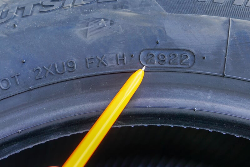

03/08/23 build date on tire
Was the number 3823? That would be the 38th week of 2023.
Tires Manufactured After 2000
For tires manufactured in the year 2000 or later, the last four digits of the DOT code indicate the date of manufacture. The first two digits represent the week, and the last two digits represent the year. For example, if the DOT code ends in "0203," the tire was manufactured in the 2nd week of 2003.
