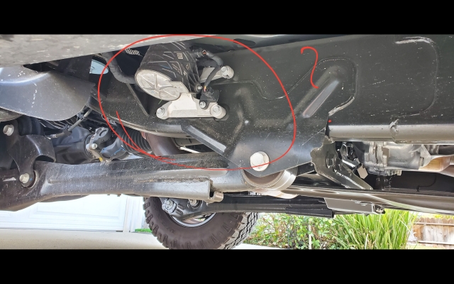

What is this.
Simply, it counters the small vibrations that go through the frame to make it smoother for the occupants.
Now how does it work ? :ROFLMAO:
Technical name is ATMM (Active Tuned Mass Module)
Active Tuned Mass Modules, ATMMs, which are essentially little cans bolted to the frame rails on either side of the truck, with solenoid-activated weights inside.
As the HEMI engine’s Multi-Displacement System kicks in, and sends the truck into four-cylinder (ECO) mode, an under hood sensor picks up unwanted vibrations, and triggers these ATMMs to shake their internal weights in a way that’s 180 degrees out of phase with the engine’s unwanted vibration, thus canceling it out and yielding a smooth experience for occupants.
Thank you I wanted to mount train horns but that is where the brackets go I dont want to mess with factory crap.
Kleinn tech support though it was ca vehic specific do you all have them also?
They are not CA only. All 1500's with 5.7.
I had a 1500 now I have a 2500 Kleinn told me it was possibly a CA only thing not
