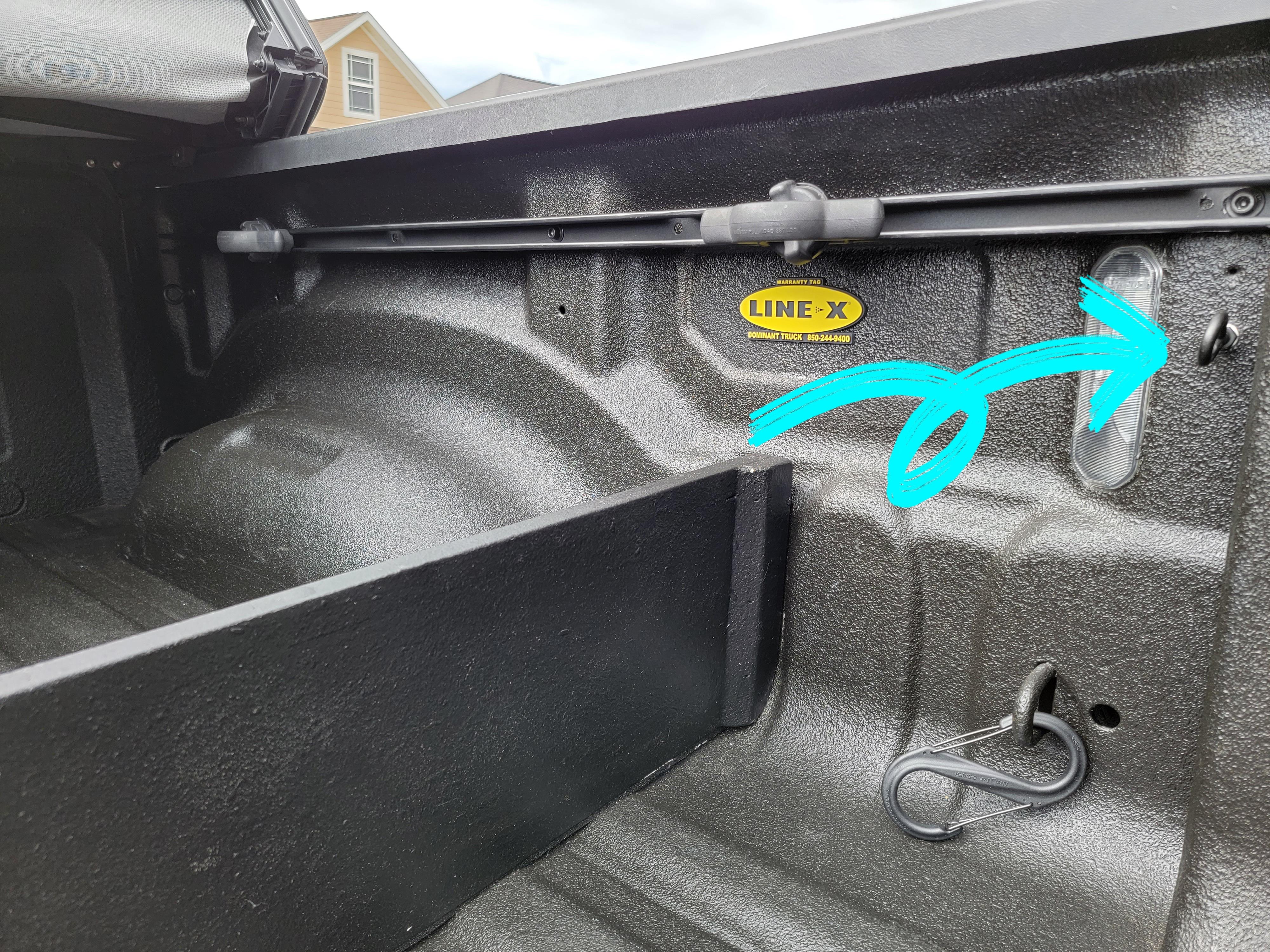

I noticed in the truck bed (sides) a series of hexagon holes. Eight on each side. If I wanted to fasten something to the side of the bed is there special fastening hardware? What have others done?
Those are for threaded inserts to bolt on the factory bed rails. I installed the threaded inserts to install molle panels in my bed shown here
