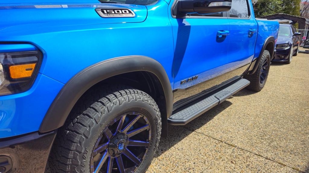

Hello all, my name is Alexandros. Posted this thread because I know someone may be interested in a similar setup as mine and want to know does 33x12.50 on -44 offset 22x12 rub ON STOCK SUSPENSION, no air ride , lifts or levels. I have a 2020 bighorn 5.7 and decided to do some research and it was hard to find any true answer on if my setup I was looking for will Rub. I am here to tell you, they only rub if you are full lock without trimming , so I trimmed about half of the liners out the front of the vehicle and experience no rubbing whatsoever. Hope this is useful for someone’s build! But to be clear 33x12.50 is the biggest tire one can go with as far as stock suspension without rubbing

If you got smaller rims, you can put bigger tires. My 34.1 in tires (275-65R20) on my 20” fuel contra. It only rubbed at full turning lock going over a bump when I tested it.
